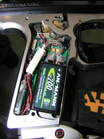

      This is solenoid used in all my EP builds so far including Creedmag. It's only 21mm long x 11.5mm deep x 7mm thick, and it fitted in the frame no problem

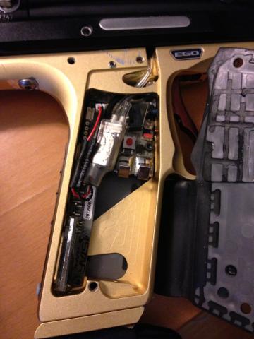

          This is what I did for my egomag using etek star frame. Really easy to do using Hill's instructions. However, I'm having difficulties doing it on my UL frame. Maybe you guys can help me.

            #50
            Wat noid did u use?
            • livebrando
              • Jun 2012
              • 100
              #51
              The one from airsoldier, SMC S070C-SDG-32. It's the same one that Renie uses too in his EP builds. Reason for the shiny is clear heatshrink tubing. Did you get a frame yet? If not, I have an extra Ego 6 Dark frame I was going to list in the sales threads.

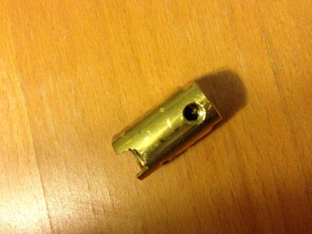

                  #53
                  I used a dremel with carbide burr bits and found it to work very well on the soft aluminum and the ram. You want slow speeds. At some point you'll have to shave the ram to fit.
                  One issue I had is drilling and tapping the bottom of the ram. You need to drill the hole very close to the edge or you'll have a useless ram. here's the picture of one I messed up.
