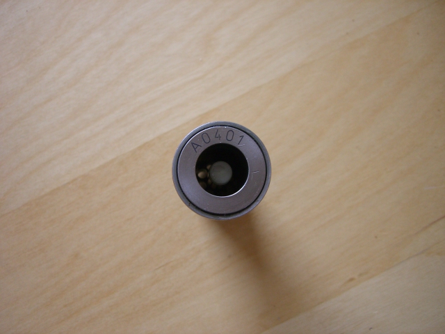

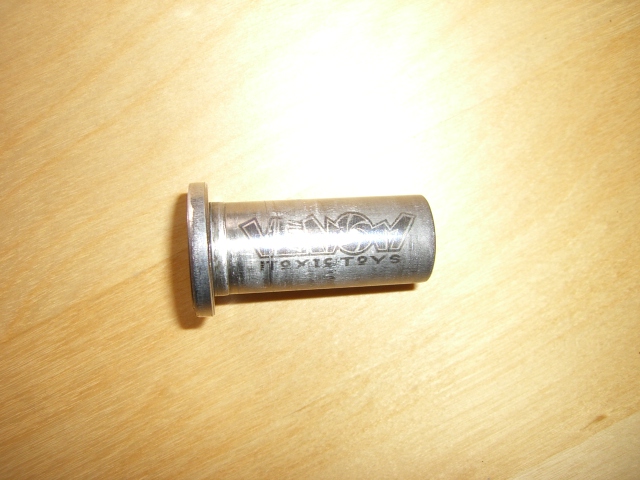

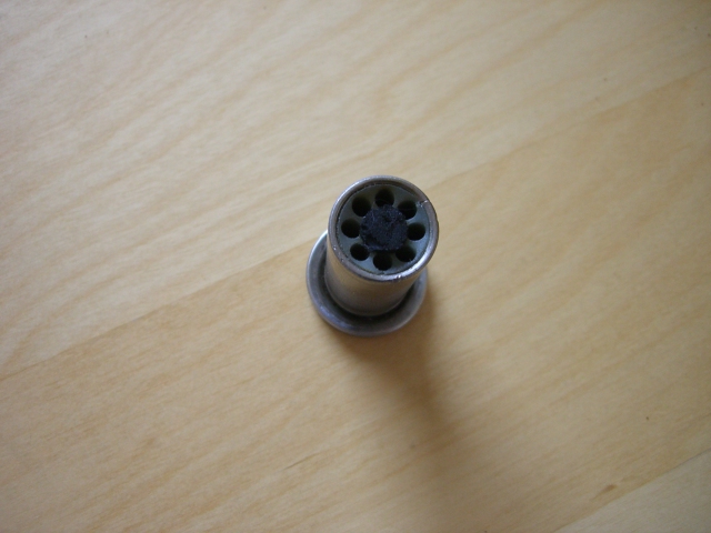

        Originally posted by Ando
        They made some out of titanium, they were called Venom bolts. They to apparently didn't hold up well. I still have one running in one of the many mags I have. Never had an issue.
        A piece of history
        The Venom Thunderbolt was made by Toxic Toys here in Germany by a friend of mine and his brother.
        Back in the day it was a blast. It was made of Titanium, glass fiber-reinforced plastic and hardened stainless steel. Very expensive to make.
        There where at least 3 versions in the bolt design (bolt face).
        The weight was round about 25 Grams which was less then half the weight of the Level7 bolt.
        I've never had problems with the bolt but some people had (seperating or wear).
        The newer AGD Level10 bolt is just a few Grams more than the "exotic" Level7 style Venom bolt and has a big plus, it prevents chopping paint.
        To get back to the first post questions:
        A lighter bolt will reduce your recoil and increase your markers cycle speed.
        The cycle speed is not a problem (RT/X-Valve with Level10 ), Recoil... well... not an big issue.
        But a lighter bolt for your Automag will not increase the efficiency in any way.
        Pics of a Thunderbolt V3 attached
