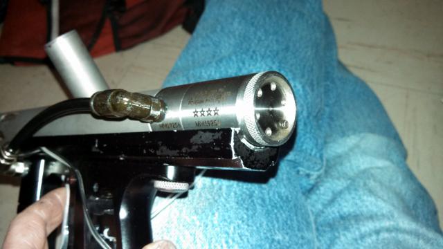

      I left out. Level 7 bolt. So even less potentials. It will not fire with the barrel off. Stiff smooth trigger pull. But no air down the barrel. No click of the sear locking the bolt back in place. Nothing. I really wish it had a factory adjustment nut on the back. Because I halfway wonder if the aftermarket piece doesn't have something to do with it. Not letting the velocity to be turned up. I just don't remember to many companies in the past making upgrade parts that were worth a crap. But even with that. I would think the bolt would spit forward some?Click image for larger version
ID:	2183226 this is the adjustment nut that I am talking about.

        If you take the velocity nut off the back of the regulator. Pull the spring pack out. And use a small rod or something to push in on the regulator piston. How far can you push it in by hand in this manner? I ask because I can only push mine in 1/16 or so. Shouldn't this be able to push in farther than that?

          Well, I didn't unscrew my reg nut since I just barely set my valve up/velocity... but if I unscrew the reg back and push the pin down to about where it should be seated, it travels about 3/16" past where the reg seat is... could probably go more but that's about where it feels like its going to stab thru my finger

            Well the pin moves freely in and out. I'm just wondering if I can't bump the velocity on that reg up enough to actually fire. I'm stumped here. I would swear the sear just isn't moving enough to unlatch. But I've gone over that so many times my head hurts.
