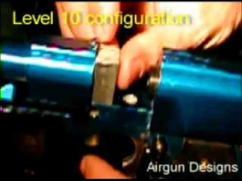

                          refer to this video as to how im testing. @0.40 seconds
