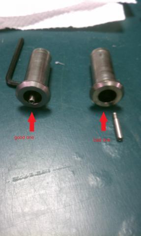

            Last but not least, I have a level 10 bolt that separated. I know they are milled in 2 separate pieces, but can i reattach one that split? I uploaded a photo.

              You can get parts from Tunamart, link is at the top.
              I think there's a guide how to repair level-10 bolt in the link I posted previously. If not, just search here and you should be able to find it.

                  All mini-mags were level 7 as were any valve that had stars.
                  You can get the level 10 carriers and orings from AGD directly or through one of the distributors here on AO. Since you have a few already, you only need a couple to round out your collection to give you enough to cover all possible sizes.
                  The level 10 bolt can be put back together. You will have to clean the stem off and clean out the pocket that the stem fits into. Use a good quality metal bonding glue. Loctite has some good products for that. Apply the glue and press fit the stem back into the body of the bolt. Let it dry for a day. The correct length is 2.010", plus you have a good one there for reference.
                  When you get your parts kits, get some level 10 bolt springs. Bolt springs wear out and need replacing.
