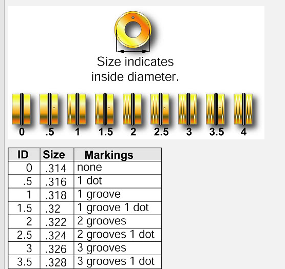

The carriers are sized using lines and dots. Each line represents a 1 and a series of dots represents 0.5. Eg; 2 lines and dots equals size 2.5. Carriers range from size 0 to 3.5 but most people only have from 0 to 2.5 and most new kits have even less.

Find the carrier size that causes the installed oring to fit freely over the bolt stem. The carrier should sit on the bolt stem without moving if the bolt is held in a vertical position. If you tap the valve on a hard surface, the carrier should be loose enough to allow the bolt to move. If you have to force the carrier onto the bolt stem with any force at all, then it is too tight. Install the bolt and valve into the gun. When aired up there should be no leaking. If it leaks, take the carrier out and replace it with the next smaller size. Always use the same white carrier oring in each carrier that you use. It is the orings that you are adjusting. Try it again. You want to use the largest carrier size that does not produce a leak.

I'll add a carrier sizing chart just for completeness.
Hope this helps at least one of my fellow noobs
