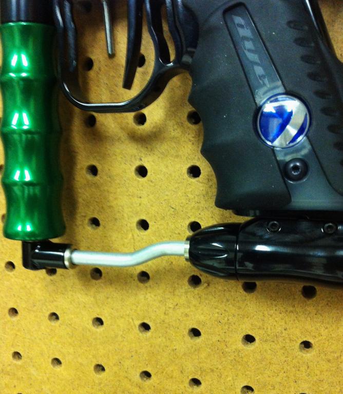

            #35
            I liked your idea so much the I used it.

              #36
              Originally posted by Mole1119
              Splat15k,
              Did you have any concerns with the how many threads you could get screwed into the valve and still have that macro fitting clear the sight rail?
              Yes, that was a very real concern; I had to use the older-style universal CCM fittings that had the longer threaded portion, which gave me the necessary clearance.

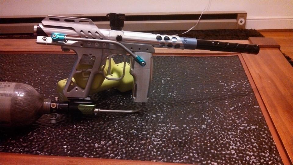

                #37
                Hmm, I will have to do some hunting, I didn't know there was another version.
                Here is my lower hard line so far, getting the bends to line up right in such a tight area was a bit tricky.

                            #43
                            [ATTACH=CONFIG]90369[/ATTACH]
                            very nice

                                #45
Name:	cm-1 small.jpg
                                I noticed I had more marring when trying to do multiple bends in a very tight area. I definitely made a mistake by ordering one universal fitting from ccm and not two, I would have only had to do one bend instead of three.
                                Splat15 your mag provided a lot of inspiration for my build.
