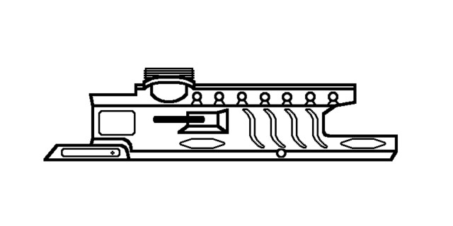

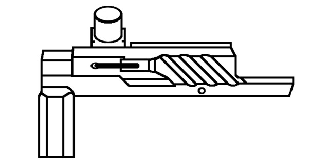

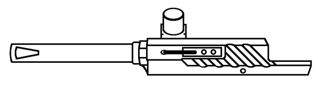

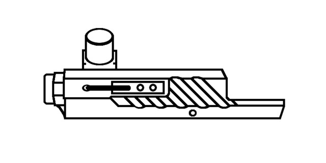

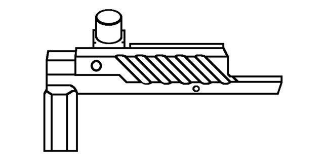

    MicroMag (Generation 1)
    -Fixed 6" Barrel
    -Powerfeed
    -Bolt On Detente
    -No Foregrip
    -No Site Rail
    -Exposed Valve
    -Classic Sear Axle
    -Winged Frame
    These are the original MicroMags, made by Pro-Team Products. They were the first aluminum Automag body and the first "unibody". This model was originally sold as a kit including body and frame (battleship gray), later as a complete marker with a branded classic valve (many finish options). Gen 1 MicroMags are easily identified by the fixed 6" crownpoint barrel and lack of foregrip. They utilize a traditional "classic" Automag sear and axle which is held in place by the upper wings of the frame, this means that flat top frames are not compatible. Tolerance issues sometimes prevent the use of Level 10 bolts, though this should not reflect on the quality of the product as it predates the Level 10 by many years, and issues can be solved by sanding/honing the breech.

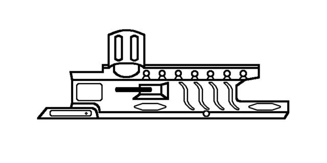

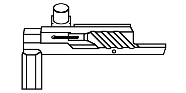

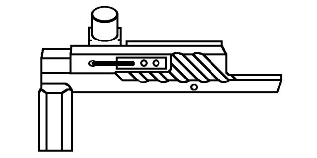

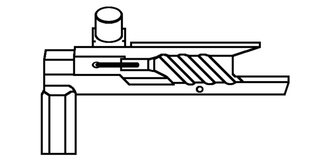

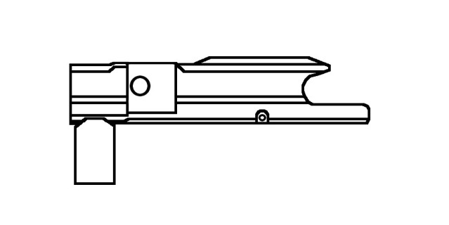

    MicroMag 2 (Generation 2)
    -Autococker Threaded
    -Powerfeed
    -Bolt On Detente
    -Vertical ASA
    -Site Rail
    -Exposed Valve
    -Classic Sear Axle
    -Winged Frame
    These are the second generation, which was referred to as the "MicroMag 2". They were the first Autococker threaded Automag bodies, and the first MicroMag to use Pro-Team Products proprietary foregrip mount. This model was sold as a kit including body, VASA and frame, and as a complete marker with a branded classic valve. Finish options included Satin Black, as well as many patterns done by PK Selective. Gen 2 MicroMags are easily identified by the bolt-on detente and threaded barrel. They utilize a traditional "classic" Automag sear and axle which is held in place by the upper wings of the frame, this means that flat top frames are not compatible. Tolerance issues sometimes prevent the use of Level 10 bolts, though this should not reflect on the quality of the product as it predates the Level 10 by many years, and issues can be solved by sanding/honing the breech.

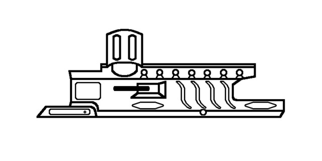

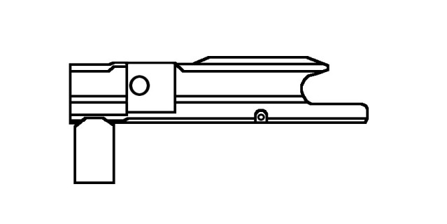

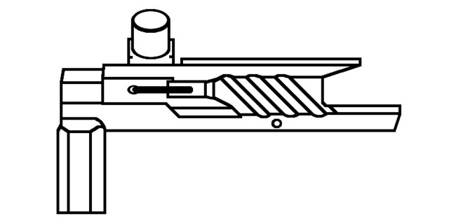

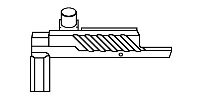

    MicroMag (Generation 3)
    -Powerfeed
    -Milled Detente
    -Vertical ASA or Grip
    -Site Rail
    -Exposed Valve
    -Threaded or Classic Sear Axle
    -Winged Frame
    These are the third generation MicroMag. This model was sold as a complete marker with choice of vertical air source adapter or proprietary grip, and a branded classic valve. Finish options included, Ultra Black, Satin Black, as well as many patterns done by PK Selective. Gen 2 MicroMags are easily identified by the ball detente milled into the body and the short site rail which leaves the top of the valve exposed. These utilize a traditional "classic" Automag sears, though some use a "classic" sear axle which is held in place by the upper wings of the frame, while others use a proprietary threaded sear axle which does not require wings. This means that winged frames are required for most models (standard axle), and while flat top frames will work with some models (threaded axle) they are not recommended as most do not fit flush with the sides.

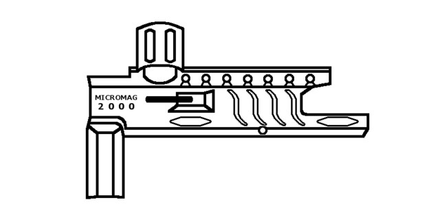

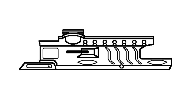

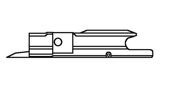

    MicroMag (Generation 4)
    -Powerfeed
    -Milled Detente
    -Site Rail
    -Covered Valve
    -Threaded Sear Axle
    -Winged Frame
    These are the fourth generation MicroMag. This model was sold as a complete marker with choice of vertical air source adapter or proprietary grip, and branded classic valve or branded ReTro valve. Finish options included, Ultra Black, Ultra Nickel, Satin Black, as well as many patterns and colors done by PK Selective. Gen 4 MicroMags are easily identified by the ball detente milled into the body and the site rail which extends over an covers the valve. All utilize a traditional "classic" Automag sears, though some use a "classic" sear axle which is held in place by the upper wings of the frame, while others use a proprietary threaded sear axle which does not require wings. This means that winged frames are required for most models (standard axle), and while flat top frames will work with some models (threaded axle) they are not recommended as they do not fit flush on the sides.

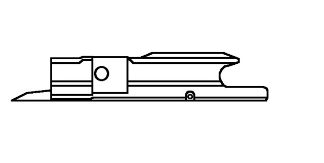

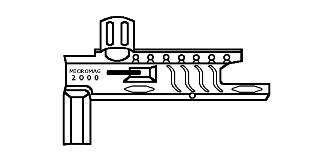

    MicroMag 2000 (Generation 5)
    -Fixed Centerfeed
    -Milled Detente
    -Site Rail
    -Covered Valve
    -Threaded Sear Axle
    -Flat Top Frame
    These are the fifth generation MicroMag in a mechanical setup, referred to as the MicroMag 2000. This model was sold as a complete marker with choice of vertical air source adapter or proprietary grip, and a branded classic valve or branded ReTro valve. Finish options included Ultra Nickel, Ultra Black, Satin Black, as well as many patterns and colors done by PK Selective. Gen 5 MicroMags are easily identified by their center feedneck, distinctive swooping milling pattern, and drivers-side milling bearing their namesake. This is the first major change to the appearance of the Micromag. The non-clamping STO style feedneck is pressed into the body, which means that the milling patterns are not always aligned identically on every model. These utilize a "classic" sear and a proprietary threaded sear axle, and accept only flat top frames. It is important to note that a small number of Micromag 2000 bodies were sold as MicroEmags, and vice versa.

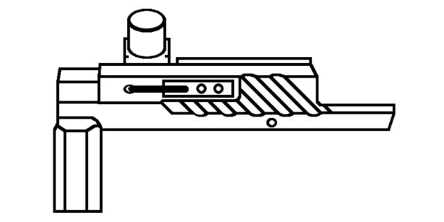

    MicroEmag (Generation 5)
    -Fixed Centerfeed
    -Milled Detente
    -Vanity Plate
    -Site Rail
    -Covered Valve
    -Threaded Sear Axle
    -Flat Top Frame
    These are the fifth generation MicroMag in an electronic setup, referred to as the MicroEmag. Pro-Team Products collaborated with Airgun Designs to create the Emag system, and released this as their own model. This version was sold as a complete marker with a vanity plate, uniquely milled battery pack and frame, frame spacer, and a branded Emag valve. Finish options were identical to those of the MicroMag 2000. MicroEmags are easily distinguished from the the standard MicroMag 2000 by the "vanity plate" and drivers-side milling bearing a small rectangle where the lettering is found on the standard model. These utilized a unique sear which is a hybrid of the classic sear and Emag sear - they are not compatible with the standard Emag sear due to the presence of a roller bearing. This body requires the use of a "spacer" which sits between the frame and the body, though the "vanity plate" which is installed to the proprietary foregrip mount is purely cosmetic. It is important to note that a small number of MicroEmag bodies were sold as MicroMag 2000s, and vice versa.

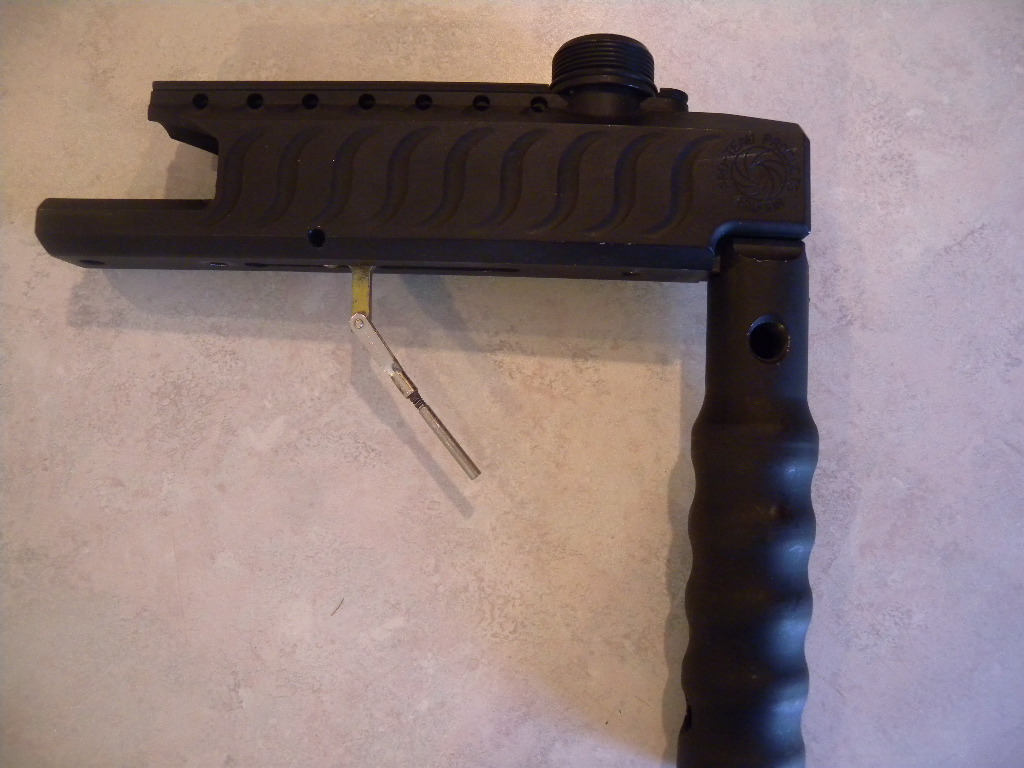

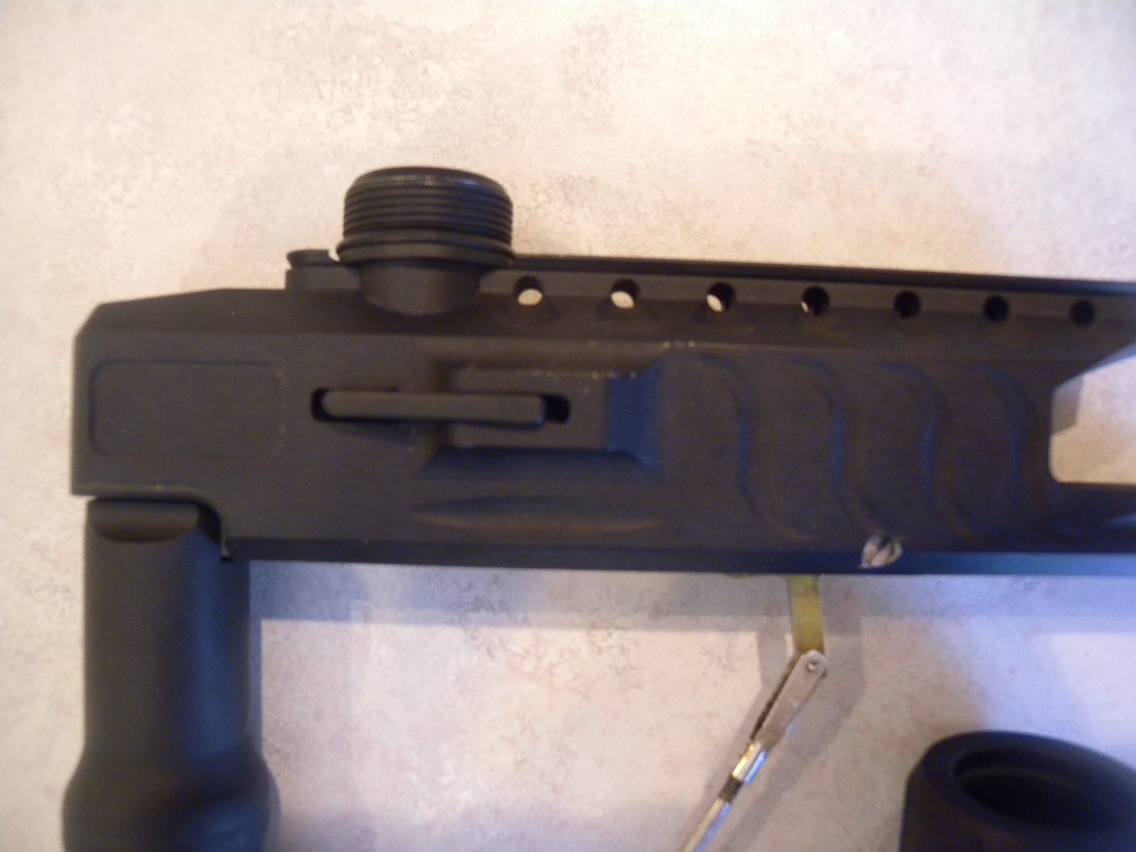

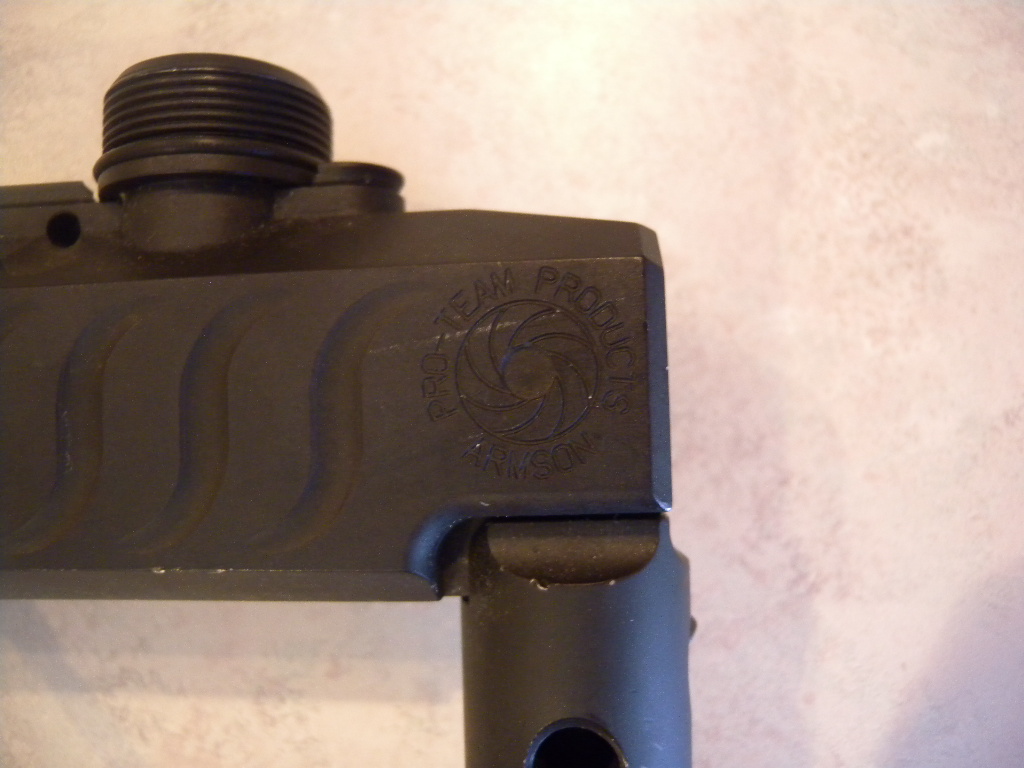

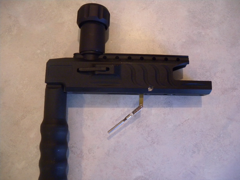

                    I've got one of the 2000 LE bodies, apparently. Here are some pics with the matching foregrip
                    BeefyDanClick image for larger version
ID:	2183879Click image for larger version
ID:	2183880Click image for larger version
ID:	2183881Click image for larger version
ID:	2183882Click image for larger version

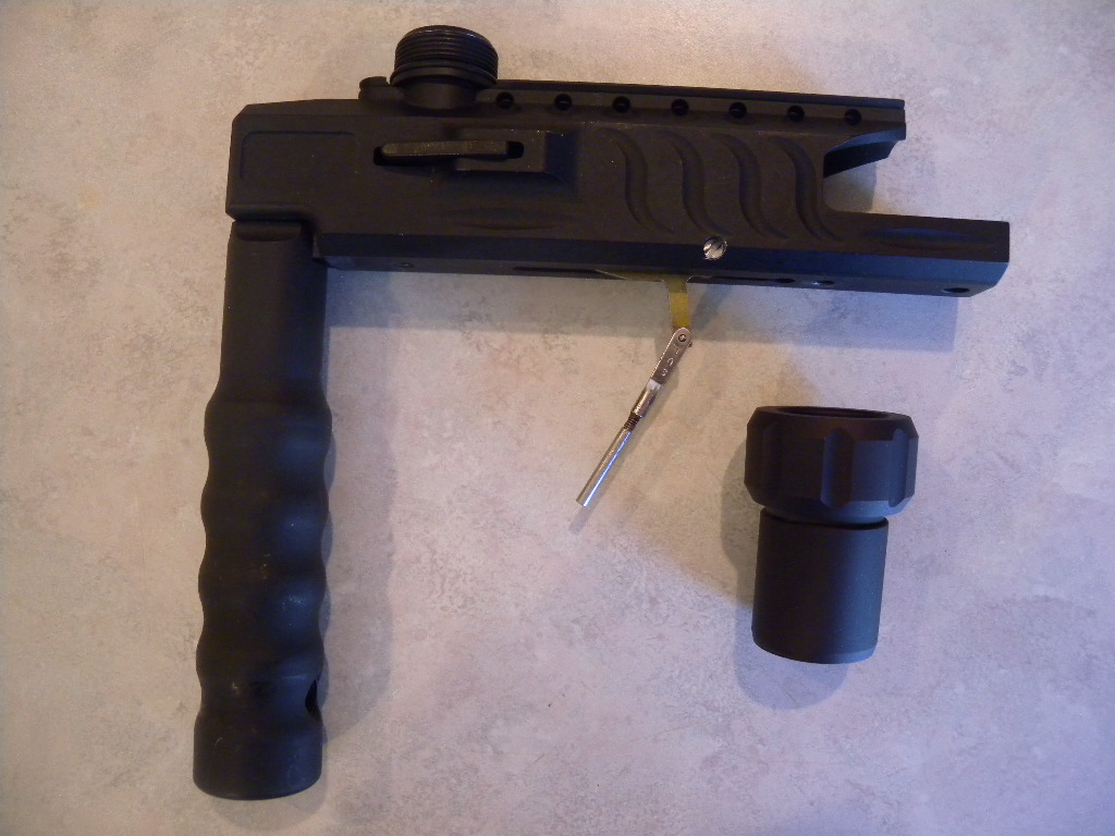

                            I also have a MM2K LE. Until this guide, I didn't know what I had was given a name although I knew they were rare.
