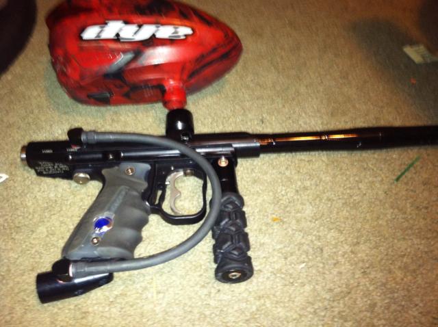

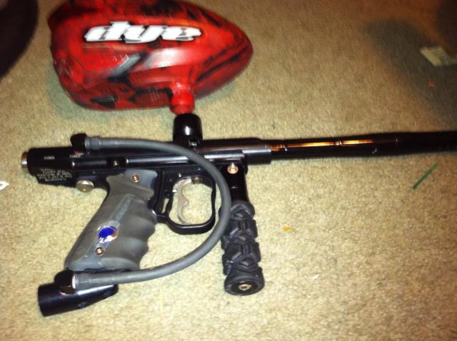

    Hey guys I am new to this forum, but I was curious if someone could help me out. I want to mount a dye rotor hopper on my Automag Rt Pro but the feed-neck on the gun is the same size as the feed-neck on the rotor. I was curious if their is any kind of adapter that will keep my gun looking good. Previously I had to make one out of PVC pipe then spray paint it, but it looked like crap. I talked to one of the people who works in the shop at my local field who also runs Automags and he told me I need something like a CCM angel feed-neck or something like that, I cant remember what he told me to get. Im am looking to take another trip to my field on September 22nd so a quick reply would be nice so I have time to order it before I play. Also my gun has matching serial numbers, is there any way to see when it was made? Serial: VV8826

    You have a ULE body on your marker and it does have Angel threads, the person at your shop sounds like they know what they are talking about, support your brick and mortar shop and go back and get the feedneck he recommended.
    There is no way to date your marker based on valve numbers.

          You can sand down the Rotor feedneck if you want it to fit, but OPBN and your Pro Shop worker are correct - it's best to replace that stock ULE feedneck with a clamping feedneck (CCM, RPG, A+Machine, etc.) that will allow more room and also clamp your Rotor snugly in place to keep it from moving.
          And if you want an on/off ASA, just save yourself the trouble and get a CP on/off, either direct mount or rail mount (you'll need a rail or drop for the latter). They're the most popular for a reason - they're just good and simple and extremely easy to operate, and they automatically vent the airline and valve when shut off. So many people use them on automags that they look like a stock part these days.

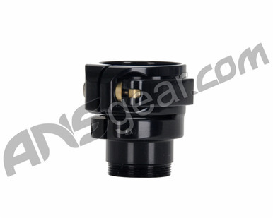

                      So something like this would work fine?
                      The Bob Long Angel one Feedneck is a great clamping feed neck that will hold any type of paintball Loader. Throw a Bob Long Feedneck on your paintball gun and upgrade your stock neck.
                        Should, but not worth the money. You can get CCM, AKA, or A+ for about $25-30. Personally, I am partial to AKA feednecks. Have them on several of my markers. They only come in polished black though. You can buy directly from AKA on their website.
