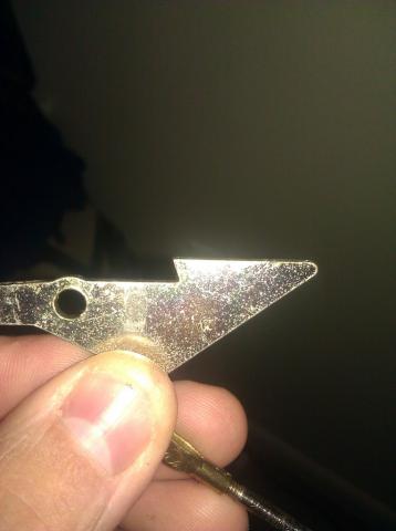

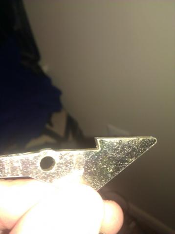

                          • Stealthpanda
                            • 129
                            These 2 pictures alone make me think the sear is fine. I don't want to be ignorant, and its a shame I am probably asking questions that have been asked since its release 10+ years, but I feel the oring I had couldnt find a nice home in carrier 1, or 0.5. Shrug, i'll find out when I get a refill Tuesday. I am perfectly fine playing with it as it was, if its only leaking when I hold the trigger in, as this isnt an issue in normal operation, as you mentioned athomas. Again, thank you all for the help, and I will delve deeper into the warpig article, as well as the various information pointed out in your post above, and the AO sticky I began reading.

                            • athomas
                              Of course it works-its AGD
                              • 8039
                              The sear looks fine but its hard to tell with the resolution of the pictures. When looking at the tip where it catches the bolt, if there is a tiny indentation (the surface is no longer perfectly flat) where it catches the bolt, then the hard surface is worn through and it is time to replace the sear. It doesn't take much once the hard surface is worn through.
                              How old is your mag? There may be enough wear on the sear and sear pin combination.
                              Make sure you snap the sear pin securely in place in the rail. Check that the rail bushing is in place.
