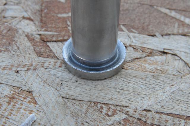

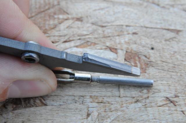

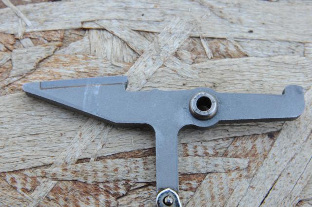

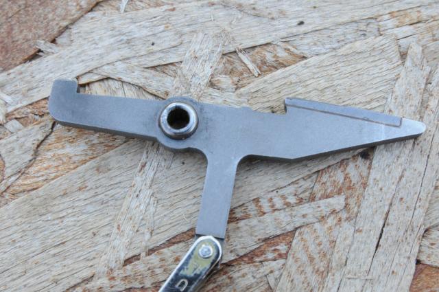

    I just recently got back into paintball (last December) and my buddy and I have been playing a lot recently. My friend had been picking up quite a few used markers. One of his finds was a used RT. It had a slight leak down the barrel. Since he didn't have time to mess with it, I agreed to look at. Neither of us have any RT experience but I love to tinker. I thought this was going to be an easy replace the o-rings, clean and lube it up kind of job. Which, for the most part it was. I tried multiple o-rings one at a time and the valve REALLY needed an internal cleaning. The last thing I replaced was the power tube o-ring and it stopped leaking and was shooting much faster than I expected it. The RT is advertised at 6 BPS and although I didn't have a chrono to verify, I'd say it was closer to double that. After about 300-400 shots, the tank was running low, I took apart the marker and found that the sear was worn down at a strange angle and had started to ding the bolt a little. To be honest I didn't look closely at the sear before I started the project but I am almost certain the strange wear pattern wasn't there when I started. I just received a replacement sear from Tuna and I want to make sure before I start up this little project again that I won't be destroying a $30 sear. Do you think the original sear was worn and/or weakened? There isn't an adjustment to the sear. The body was attached to the rail tightly. Is too tight bad?

    Oh yeah. Is the bolt shot too? I have a few others I could drop in if need be.

      That old sear is one of the earlier models of RT Pro sear. Can't remember what was the name of that metal that's on the catching edge (carbide?) but it could chip like that, that's why it was changes if I'm not mistaken. That bolt looks little worn down but I' don't know if that's too much. Cue Athomas
        • 8648
        BOTH the sear and bolt are shot. Do not use that new sear you just bought on that old bolt. Change the bolt.

            The sear is noticeably damaged. The bolt is rounded and dinged at the edge where the sear catches it. A new bolt to go with your sear, and the gun should perform nicely.
