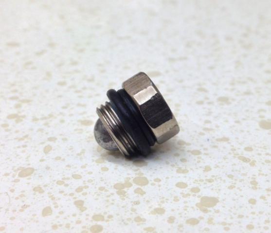

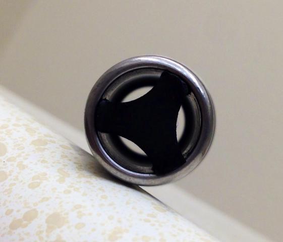

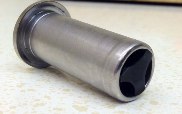

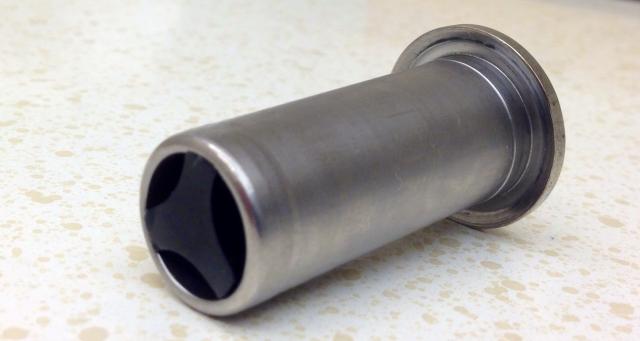

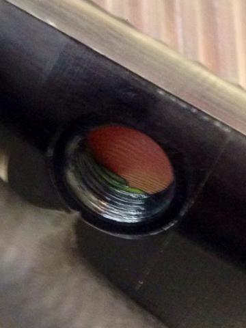

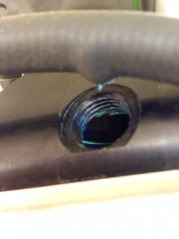

                  I'm starting to think that it may just be the quality of the detent, and fact that the ball is metal. I think the white detent balls made of delrin may be a better choice. I'm puzzled though, because the stock AGD detent that was provided with my ULE custom had the white delrin ball shot out as well.
                  Here's pictures of my bolt. I also included a picture of the detent, w/ o-rings to show the amount of spacing I'm needing, in the hopes that my detent ball doesn't get shot out.

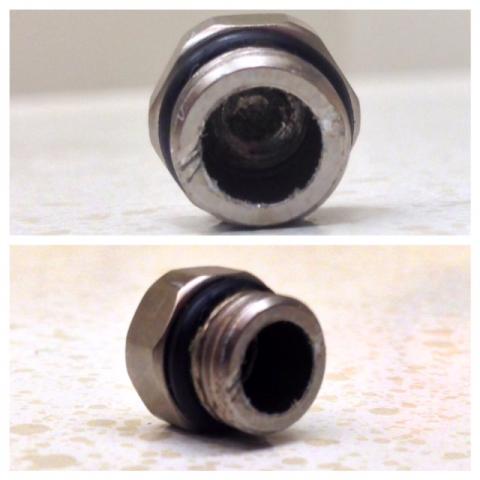

                  I think I found the issue. I removed the detent from the ULE body, and cleaned the threads on the body itself as well as on the detent. I found, that when rolling my finger across the metal detent ball back and fourth, that the metal ball tended to stick. I'm thinking that because the ball is sticking, that it's causing friction as the bolt moves forward, causing the bolt to rip the ball from the detent.
                  The picture below shows the detent itself marred, not so much by the detent ball itself, but possibly from the detent spring after the ball has already been shot out.
                  Opinions?
