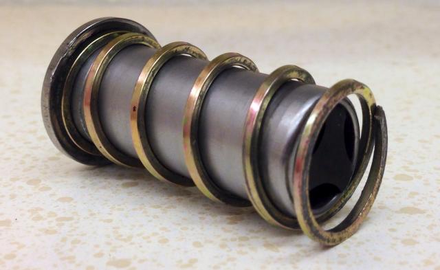

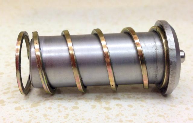

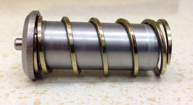

    Is my bolt spring worn?
ID:	2192987Click image for larger version
ID:	2192988Click image for larger version
    *Older feedback
    *Pbnation feedback
  • athomas
    Of course it works-its AGD
    • 8039
    That looks like normal compression for a good bolt spring.
    The only way to really know for sure if the spring is bad, is to measure the amount of force it takes to compress it a given difference. Since that if more difficult to do, we just use the simple look and see method. However, the best measure is if the gun is cycling properly. If you are getting bolt stick issues when all other parameters are set properly, then it is most likely a weak bolt spring. This was easy to determine on the level 7 mags, but is not so easy on the level 10 mags. The bolt spring is a consumable item. Every so often (usually around 30000 cycles) , you should just change it as a matter of doing your general maintenance.
