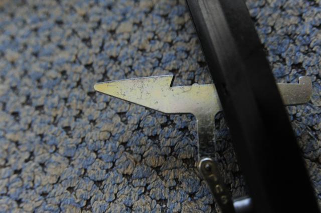

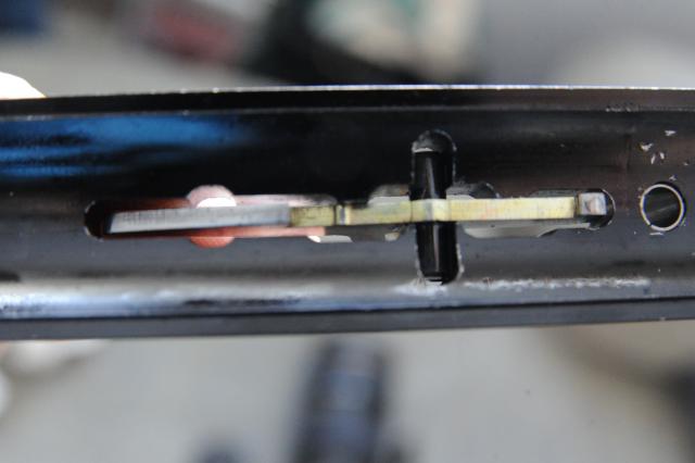

ID:	2183642Ok. Got the difference between carriers and spacers. Sorry for my ignorance. It's still new to me. I ordered a full set from Tuna - springs, carriers and shims. Waiting for their arrival. I cleaned the entire valve and all looked very clean. After cleaning the valve I dry fired it and heard a very slight hiss coming from the valve after a short string of shots. This hiss slowly went away after about a second. If I wasn't specifically looking for a hiss, I would probably miss it. There was one shim installed with the carrier. I removed the shim and dry fired again. This time the leak was more pronounced and went away after pushing down the bolt. This seemed more like what I was experiencing while playing. Should I try testing with paint? Or is dry firing ok? I took pictures of the sear. It has some wear but would you consider it shot?Click image for larger version

              The sear doesn't look bad, but it is hard to tell from that picture. It is an old sear, and even a tiny bit of wear on the face that holds the bolt can cause the bolt to sit farther forward and allow the bolt stem vent hole to be exposed.
