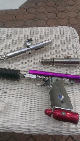

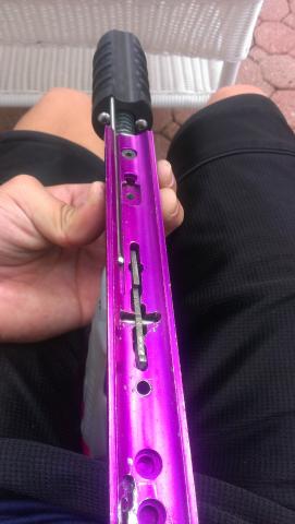

    I bought an xm15 pump kit with the pump milled rail and tried to throw a ule body on it but the pump rod can't reach the valve. Do I need a pump milled ule body too? Or am I just missing something. Any feedback would be great, thanks

    Body always needs to be pump milled. One in the picture isn't.

      hahaha, I didnt catch that
        Would you happen to have or know where I could get one?
          You can get one milled for pump by Luke.
            Yea ill try the wtb section first and if not I guess ill have to go that route. Would you happen to know if it being a pump milled body, would affect it at all as far as if I wanted to use the body on another mag that's not pump?
              No, doesn't affect its functionality in anyway. Just allows the use as pump as well.
