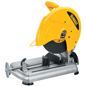

                  did Nobody actually post the words chop saw in this thread?!
                  yes, but if was in reference to the OP.
                  Originally posted by thecroatiansensation
                  Would a metal chop saw (or a mitre saw with a metal blade) be the best bet to do this modification accurately?
                  in metal working, a chop saw is this.
