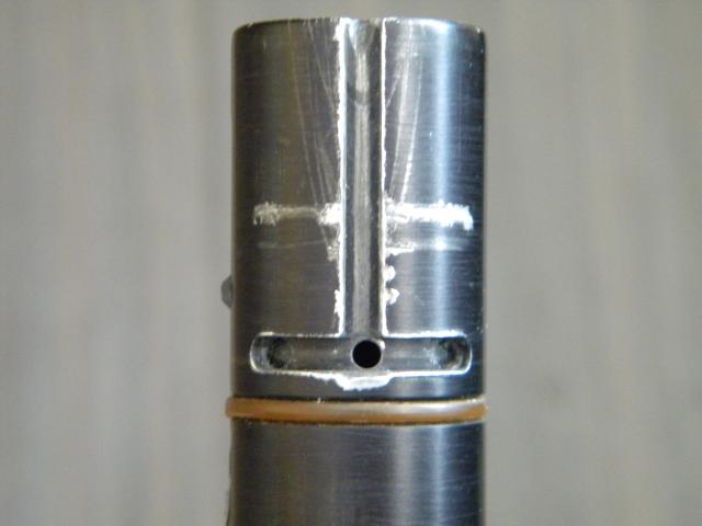

Just to add another option. If you have a TL barrel that you like. You can actually drill a small indention in the slot that actually crosses the feed hole. And make a vertical notch out of what you have. Some use this option. Some prefer the proper TL slot.Comment

Sorry. Re reading my wording sounds like I'm saying to actually carve the slot. No no no. Most likely one of the slots you already have has a point in it that puts the barrel in the perfect position. All you have to do is drill an indention at that point in the slot that is already there for the TL pin to set in.
Sorry no pix from me. I don't have a vertical body. I've just seen this done a few times.Comment

I have notched several barrels, its seriously like a 1-2 minute process. Way easier and cheaper than hunting down a factory center feed barrel.Comment
I don't mill a slot. I use one of the preexisting ones and just drill an indent.Originally posted by blackdeath1k View PostHow the heck did you put a smooth strait slot in them without a mill?
Two examples:
An honestly, most times you don't even need to do this. A lot of my barrels fit so tight that they rarely twist from left to right without significant force. The indent is just an extra precaution.Attached FilesLast edited by OPBN; 02-12-2014, 08:50 AM.Comment
