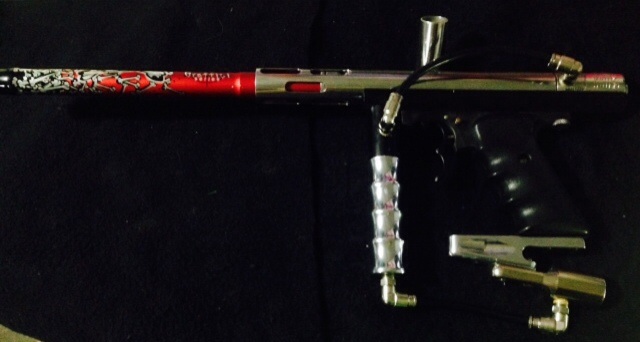

                Thanks. I'll be getting in touch with tuna man shortly. Lastly, I've noticed that the Mags now have a vertical feed and no need for an elbow. How is that achieved?
                throw us a picture and we'll tell you where to find it... theres a lot of vert choices now

                  Here you go. Everything worked fine yesterday but I need to bring the gun up to speed with everything else out there

                    Man looks nice
                      Nice. Reverse MIniMag valve. You'll probably get a couple of PM's from people wanting to buy it. Personally I would just find an Intelliframe, out an RT Pro on/off and maybe a level 10 in it and call it a day.
                      If you are set on a valve that RT's look for a Retro/RT/EMag valve. They can usually be found for $100-120 depending on whether they have an L10 bolt. Used X valves sell in the $170-210 range depending on condition.
                      While it's fun to RT, it's not necessary at most fields IMO. Most times where I play ROF is requested to be kept down especially if you're playing with rentals. Personally I haven't played with anything but a pump for nearly 2 years of rec ball.
