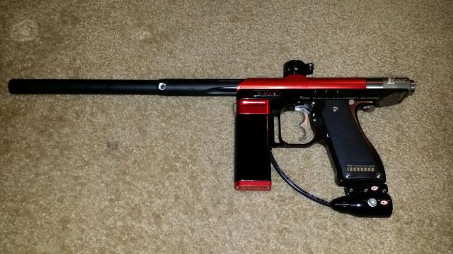

    Just received my Emag. Version 1.37
    I have 0 issues with mechanical mode, but e-mode does weird things. Fire, wont fire, fire, fire, wont fire. I haven't tried hybrid mode, just because recently it said Low batt But prior to that I noticed the trigger pull was 2-4 mm long. Felt weird? Tight? The trigger magnet on the back of the trigger appears to be dirty/rusted. And behind it where the HES is was dirty. <-- Ok, both are clean now. Moving on. The sear plunger moved well for the gravity test. And TBH, since it said low batt, I am going to stop there and wait for my charger tip to come in... full charge, and see if i have any of these e-mode issues. I read something about the plunger solenoid and how much power it draws/etc. Oh, and I destroyed my saftey by not paying attention. Through various threads I found in the past 10+ years, I have a sinking feeling that I am not the only one who has fubbed up there saftey (lost the ball bearing) Hell, I even smashed the safety through the spring beneath it... and that was NO fun trying to get out. $2 lesson learned.
    Something else I learned. It appears that my X valve'd RT ULE doesn't RT as well as my Emag does in mech mode. Does/could this have anything to do with the on/off pin length? And is it safe to assume I could put my X valve w/ emag on/off pin/quad oring, in place of my emag valve and rt on/off pin oring combo.
    Little things I have noticed about my emag...
    Thanks alot guys,
    Jason

      I figured the X valve would drop in, but before I checked what parts were what, I noticed a different o ring on the top of the emag on/off and the pin length difference. So thats that.
      I, honestly, destroyed my own saftey. I pushed it too far, and never even saw the ball bearing pop out. So when I tried to push it back in, it smashed the spring in there between the frame/saftey pin itself. Getting the saftey pin out AFTER I had ran that spring over was REDICULOUSLY tedious. I see the ridges you are talking about, and those angles are pretty catchy (pun intended).
      The charger bit comes in tomorrow, and I noticed that I have this...
      So.. cool, its the newer/more powerful battery that someone (iirc) on this forum created. So with the generic radioshack charger, 12VDC/1500 mA, how long would/should I charge this battery for? I do know that once its in the green, its not fully charged. 80-90% or so, I saw a post here mention. So that covers that.
      Sooo... onto the trigger adjustment/HES. I have noticed that on top of the trigger is this:
      I can add a magnet or two to increase return strength. You have me that far. Ok. Next
      Inside of the selector switch is a set screw that controls the pull return distance of the trigger. Well, I have tried to fit an allen key in there, and nothing hooks. They are either too big, or just spin and spin. Probably stripped. If I cannot get this to work, I will have to purchase a new selector switch and replace mine. I heard there is a ball bearing spring combo underneath of the selector switch, and this makes me sad.
      Next:
      There is another set screw in the middle of the trigger. This set screw hold a magnet on the opposite side, which interacts with the HES, and registers trigger pulls. Again, the set screw is probably stripped. New trigger > replacing the old trigger.
      Overall, I will have to mess with it more once its charged. I am not very good with electronics, so the best case scenario is that it doesnt give me any more problems in e mode. Worst case scenario is that I send tunaman an email and get this squared away before the weather gets better
      I just tested it, and even with it screaming low battery I wasn't having any issues in mech mode/hybrid mode. There is something plunger/solenoid related that makes the gun not fire every trigger pull in e mode. Its like that selector switch set screw doesn't let the magnet in the back of the trigger get close enough to the HES switch.
      Figured I would update the thread out of optimism.
      Thanks,
      Jason

          :O Just managed to find an allen key that fit the selector switch... turned it a bit, trigger pull length in e mode feels about 3-4 mm, vs the 1-2 mm before. Was cycling before I ran out of air. Between air and a full charge this looks promising.
          Thanks,
          Jason
