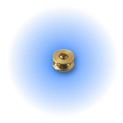

                              Ok finally, tell me what I have here
                              Sent from my Moto Z (2) using Tapatalk

                                #60
                                That looks like a standard AGD on/off for the Automag/Minimag valve. Missing the top, however. The newer (since mid 90-ties) looks like this:
