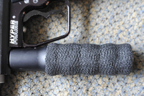

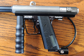

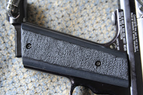

          I started with the fore grip. The person in the magazine article that was using this product was making a custom ergo mouse that needed to be skinned with sugru. He said he rolled out the sugru flat with a rolling pin. This didn't work for me. Had I known I was going to have some issues at this stage I might have watched a few more youtube videos. The sugru either stuck to my rolling pin, table or cutting board and it stained my white cutting board. Since you only have about 30 minutes to work with sugru before it starts to soft set, I free formed the sugru to the grip. I used 3 packs on the fore grip. To add texture, I rolled a washing machine lint catcher into the still pliable sugru. I also considered using screen mesh from a window. Here is a picture still in progress of adding sugru;

            I wasn't happy with it at first but added a little more and it dried a different color.

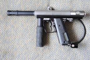

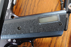

            I think it looks a little better after it had about 12 hours to dry. I then used about 1 and 1/2 packs on the side of the grip with the window and about 2 packs on the other side of the grip. To make sure the sugru was consistently placed on the grip panels, after it was applied, I rolled the grip panels face down on my table top. It didn't stick as much as with the fore grip. By rolling the grips on the table, I was able to identify low spots and added more as needed. After the sugru was applied evenly, I added texture with the lint catcher again (making sure to leave holes for the grip screws). I was a little happier with the results I got with the grips.
            After about 12 hours of curing, the rubber is very solid but with a little bit of give. Almost the feel of the rubberized focus ring on my Nikon camera.

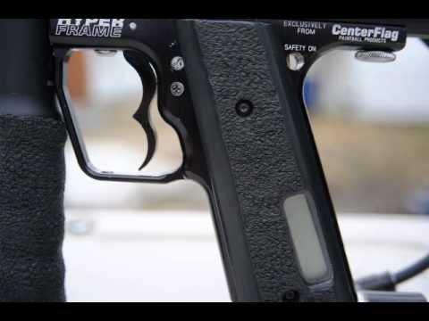

                      The pictures were a little smallish - here is some video.

                              • 220
                              I used the hyperframe with the sugru grips over the weekend. The weather was nice but the field was VERY muddy. The extra grip that the rubber provided made for a better hold. I managed to get mud on the fore grip and grip panels. The rubber held up to a light scrubbing with a toothbrush to remove the caked on mud without removing or damaging any of the embedded rubber. In all I am happy with it but the next time I try added it to something I'll be a little more creative with pattern. I'll update if I have any issues with it flaking in the future. Let me know if anyone else decides to use this, I'd be interested to hear about your experience.
