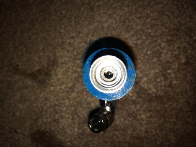

    Classic 68 Valve - doesn't take level 10
    Are some of the classic valves incompatible with the level 10? The bolt wont slide all the way down the power tube? I tried to put it on a "Field" stamped 68.
  • Levi
    • Mar 2013
    • 249
    I believe the "rental" version of the classic valves had a restrictor in the power tube that limited the maximum velocity.
    I have heard that they can be drilled out though. I've never personally had one so I can't say for certain. Hopefully someone who has can chime in on this.
    • athomas
      Of course it works-its AGD
      • 8039
      That is a rental valve as indicated. Yes, the powertube can be drilled out. I can't remember the size of the drill bit off the top of my head.
      • djinnform
        Rental Hunter
        • 651

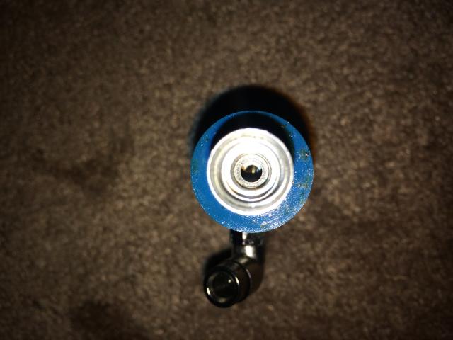

        IMG_0287.jpgIMG_0287.jpgIMG_0287.jpg drill down in here?
        • athomas
          • 8039
          Yes. You need to drill the small hole out to the next larger one.
