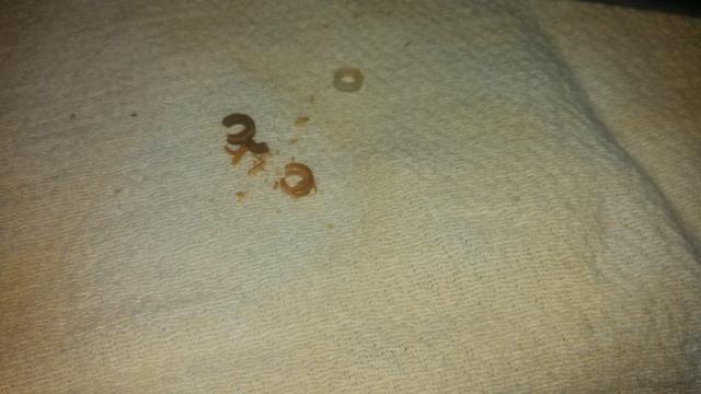

        Well my rt worked remotely fine the first time. (After I broke the bolt / bumper / valve apart). But it quickly started going down hill. All of my Orings were a yellowish brown. The 2 Orings and the plastic clip that go on the main reg pin were actually somewhere between orange and red. And hard as a rock. I know for a fact they were as old as the gun (97 I think). They actually exploded the night before the white river scenario I played. Pretty sure I took a picture of them........... found it. Hard to see the actually freying. But they splintered off almost like when you break a piece of fiberglass. And yet these actually shot 3 cases of paint last year before the gave out.
