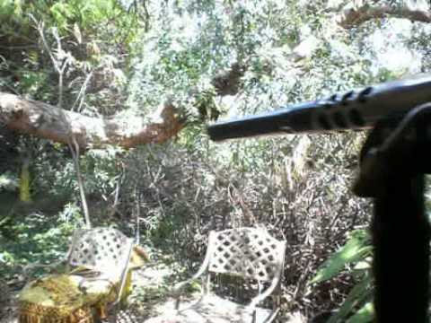

                    My 1996 is fully operational and leak freak, thanks to your advice on rebuilding the pin valve assembly. Here she is testing an Inception Designs Pico loader with halo b board (sound activated.) Ninja SHP reg tested at 1100 psi output and tuned Level X, chuffing at end of video.
                    Look Ma, no chops!
