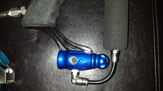

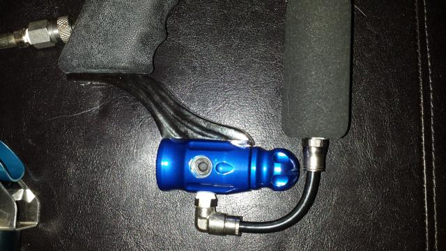

          As for the ASA it is an on/off type, and I'm screwing in a Ninja SHP reg (factory @ 1100). I back the on/off knob all of the way out, and then screw bottle in, then screw knob back in until I hear it pressurize. But I can hear a faint hiss at the knob. Here's a picture of it

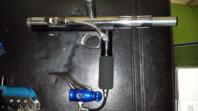

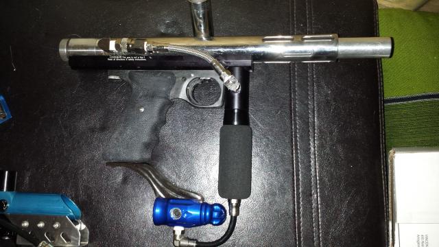

            Here's more pictures
              well, i'd try to take the knob off. there might be a set-screw holding it on. once that's off, you'll have to take the internals out. they might slide out in the direction of the knob, or they might slide out in the direction of the tank threads. once that internal pin is out, you'll have to change the o-rings that seal the pin to the asa. you can buy o-rings for cheap on mcarterbrown from this gentleman here.
              to find out find o-rings you need, you'll have to measure the channel the o-rings sit in and use a chart for find the correct number. here is a chart. look on the right columns "nominal ID" (this is the inner diameter of the o-ring, and should match the outer diameter of the asa pin channel that the o-ring sits in) and "nominal OD" (this is the o-rings outer diameter, and should match the inner diameter of the hole the asa pin slides into).
              so for example, i recently rebuilt my evil on/off asa. the pin that the knob pushes simple slides out of the front. once out, i took the two gooey o-rings off of the shaft, and measured the o-ring channels with a pair of calipers. the OD was 1/8", so that means i needed o-rings with an ID of 1/8". looking at the chart, i found the o-rings with a nominal ID of 1/8", which were size 006. so that's what i ordered from short (the mcb o-ring guy), in 70 durometer, and now my evil asa works as it should.
              speaking of o-rings, tank o-rings are size 015 (get 90 durometer urethane if possible), and the o-rings in macroline and quick-disconnect fittings are 010 (70 durometer buna). so if you ever have a leaky macroline fittings, just pop the collet off and change the o-ring. lot cheaper than getting a new fitting!

                Well I figured out the ASA problem. I pulled the knob out and cut some of the threads off. Now I can screw the tank all of the way into the ASA on/off until it seats, then screw the on/off knob down to engage air and no leaks. Basically the knob screw was way to long.
