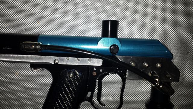

    What will fit this feed tube?
    I'm not even sure which brand this body is. But I would like to buy a "low" feed neck to go between it and my Empire hopper or if this thing comes out I could buy something and press or screw it into the body. I'm not sure if this presses in or screws in. What are my options? The ID measures .750 and the od measures .866. My local paintball store didn't have anything. May seem like dumb questions, but it looks like I'm going to have to guy something online, and I can't hold it or try it on so I figured I would ask some of you.
  • dboggs79
    • Jun 2010
    • 467
    Yes, the feedneck you see in the picture screws out and a standard feedneck will replace it. What is in the picture is used for a warp feed not a regular loader/hopper.
    • PsychoJester
      • Mar 2014
      • 110
      Is there an easy way to get that thing out without tearing it up?
      • dboggs79
        • Jun 2010
        • 467
        If you cant get it out with just your hand, you could use a heat gun on it and GENTLY turn it out with pliers or something. Wrap it several times with tape and turn more than you squeeze. Soaking it in hot water might also work if you dont have a heat gun.
        • PsychoJester
          • Mar 2014
          • 110
          Just got it off. I read a post somewhere on here about putting rubber bands around it for grip, then spinning it off. It worked perfect and no damage
          • PsychoJester
            • Mar 2014
            • 110
            Just found the original feed neck that goes on here.
