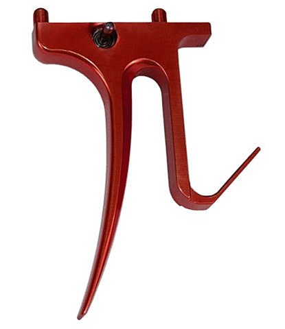

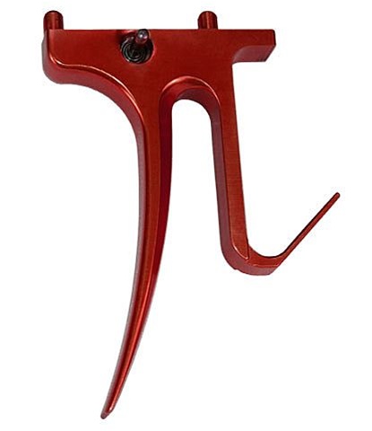

                      I forgot that the triggers for the 2005 were different than the 2004. I am just realizing that now. I'm not sure if the optical sensor in the 2005 has the metal strip. I assume it does, but locates it slightly differently which is why the different trigger design is needed.
                      Ratt: What metal piece are you talking about? There is no metal piece attached to the back of the trigger, just the hook at the back which is part of the trigger itself. See picture: CP-ANGEL-SPEEDTRIGGER-2.jpg
                      If the metal hook has been removed from your trigger, you should probably get a new trigger. If the metal piece you are talking about is the one on the optical switch, then you can use your own trigger to figure out the dimensions needed. If the metal piece on your optical switch is missing, you should probably get a new switch.

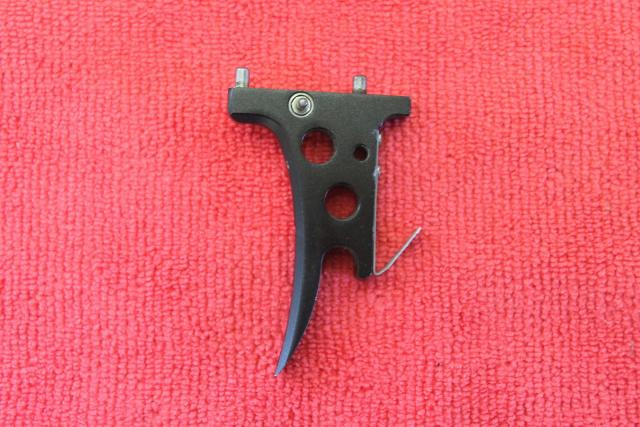

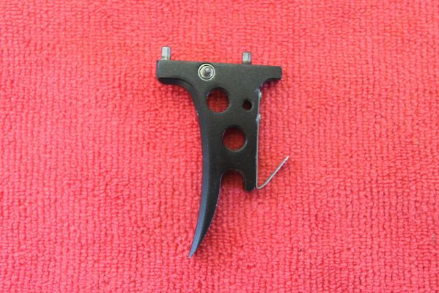

                        The metal piece I am talking about is on the trigger itself. This is the trigger that I am talking about:
                        There are some weird metal rivets/posts that hold the metal piece to the back of the trigger. You can barely see them in the photo.
                        I will take another look at the optical switch, but I am pretty sure that it is good. I may end up buying a new trigger, but if I can make my own metal strip as close to the stock strip as possible, I may be able to save myself $20. I made a strip using the brass insert from a 5.56 stripper clip. I just need to cut and trim it to match the stock strips' specifications. OR, if someone has one of these triggers, and could tell me what the angle of the bend is, and how long the strip is after the bend, that may be enough for me to fix it.

                          I see now. The trigger I referenced may be an aftermarket one.
                          That bend angle looks to be about 45 degrees. You can make minor adjustments as needed. The rivits on your trigger should come out with some persuasion.

                            Yea, I was able to get the rivets out and used them to mount my homemade metal piece.
