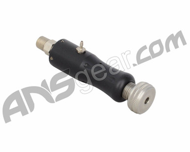

              and you would need a LPR, right?
              ANS adjustable jackhammer - 29.95
              ANSgear is the worlds largest online paintball store. Huge selection of Paintball Guns, Tanks, Masks, Loaders, Harnesses, Barrels and more. Fast & Free shipping will keep you up to date with all of the best paintball gear.
              not sure if it would fit in the frame, a palmers microrock is what i normally see, but the lowest on one of those is $54.00
              you could mount it on the outside on the ASA from what I have seen...
              other then that, the pneu specific parts are kind of set from what I have seen. The two links I provided are where you could shave the most money off.
              This thread seems to suggest that the palmers MicroRock LPR is rated at 1300 psi and is the only one with a high enough input to get the job done
              most others are max 850 psi input.

                Lol Dammit! That's going to be a big hit to the budget going with microrock, but i still think i have some wiggle room in some other departments.
