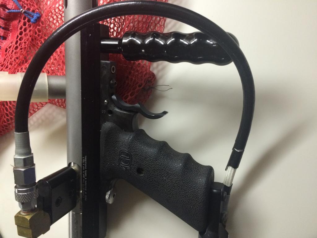

    So the bottom of my high pressure hose is losing its rubber/plastic outer sleeve but the braided mesh interior is still intact and does not leak. Is this a hazard to continue to play in its current state?
    I am trying to replace it (I need a 15 inch hose) but trying to buy a replacement I can only find it in 32 inces. If i have to cut and add the connectors myself, what tool(s) do I need? I've been told a "swage tool" but I can't find the right one.
    Is there a better set up than the one i'm currently using?

    Thats just cosmetic flaw.

      You can find a 12" braided air line often in the "misc." parts form. And not long ago I saw a post for some shrink wrap if you want to keep the black look or Radio shack sells it also. I wouldn't suggest trying to do a homemade air line. Keep in mind that your dealing with hi pressure of 800~1000 psi. If it blows out you'll need a change of underwear. You could also change out the braided line with macro line, add a straight fitting to the QD and a macro elbow on the bottle adapter.

          there is no need to have a quick disconnect if you use macro line, as the macroline fitting itself is a quick disconnect. you would simply use two 90-degree swivel elbows and whatever length of macroline needed. the hard part would be getting an uncut length, as most come pre-cut at 12".

            Get a short piece of heavy duty heat shrink and put it over the line you have now. It will keep dirt away from the braided shield.

              Yeah nix the QD, I see you must remove the tank to de-gas anyway. "Macroline guy" sells 5' and 10' lengths.

                  As far as I know the inside diameter is directly related to its pressure rating. So that's worth to keep in mind if you play with higher output regulator.
