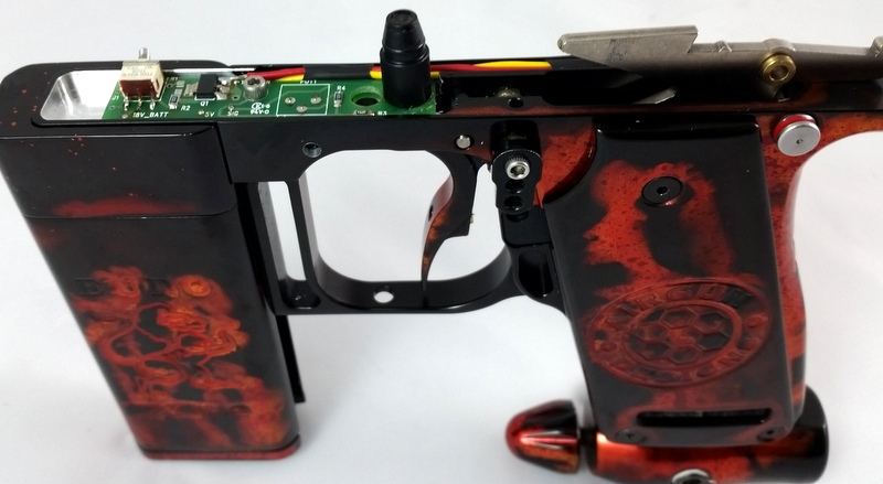

                    done - My Euro Xmag now also has an ACE on it!
                    Thanks a lot to Tuna and XMT!
