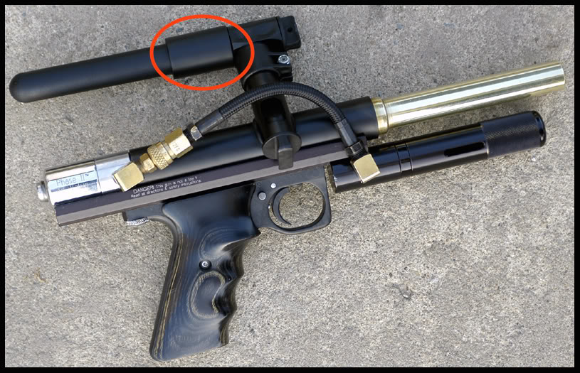

Can anyone identify the feed neck part in the pix?
  • ideinit
    • Mar 2006
    • 127
    Hello all,
    I found the following picture of AutoMaggerIX's pistol Mag from 2008:
    (originally from this thread)
    Can anyone identify the circled part that connects the Warp feed neck to the feed tubes?
    Thanks!

    I'm guessing 3/4" CPVC that's been rattlecan'd black.

      PVC sounds about right. We used to use it for feedtube adapters when using 10 round tubes. If you heat the end of a 3/4" PVC pipe until it gets soft and shove the rounded end of a 10 round feed tube into it and let it cool, it is a perfect fit for the 10 round tube and makes for a nice adapter.

        Thanks for the suggestion for PVC connections. Dropped by Home Depot and realized it's actually 1/2" PVC. Will require some sanding and fitting, but it should work!

          Its 1/2" if you are using adapters because the adapters have to fit the larger outside diameter of the pipe not the measured inside diameter. You use 3/4" if you are using the pipe itself, because its the 3/4" inside diameter that you need.
