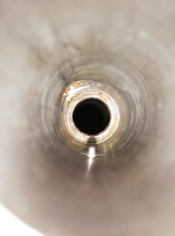

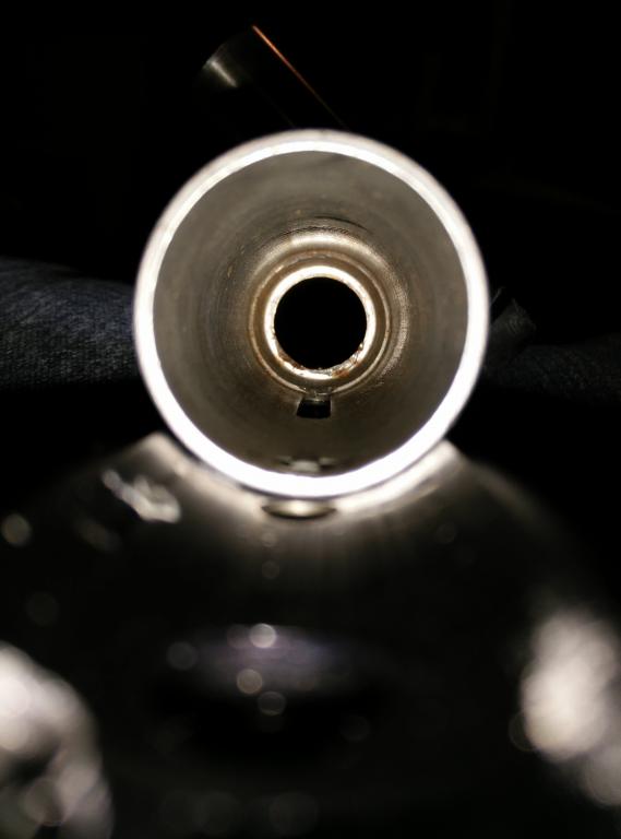

                So pictures took a little longer than expected but with the flash it was actually much easier to see what was going on in there. Clearly some distortion in the lower half of the back of the washer and from the front it looks like it has mushroomed out a bit.

                I'm cool to just file this down?

                  Its fine to file it down. You should carefully file it all around the inside so that it stays round. Try to keep it even so that the bolt doesn't get pushed to one side more than the other.
