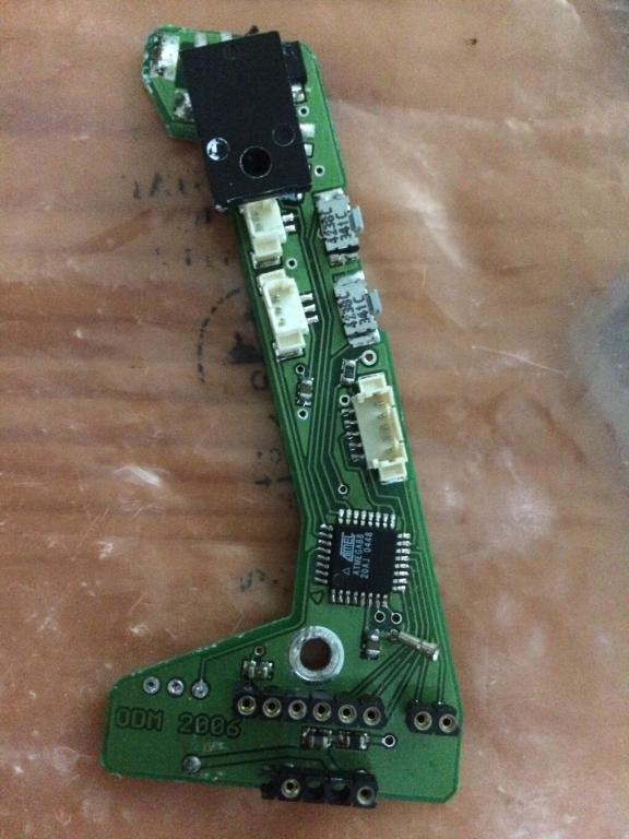

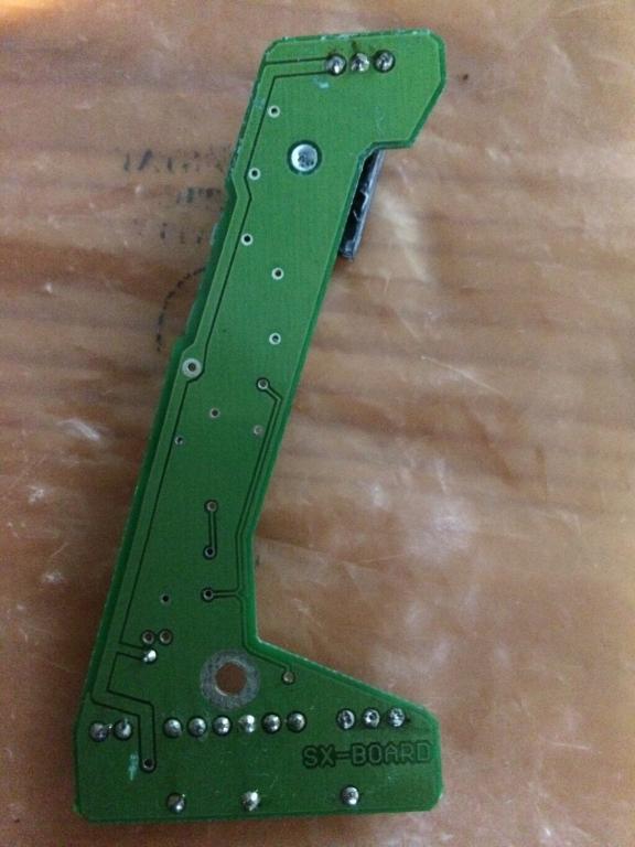

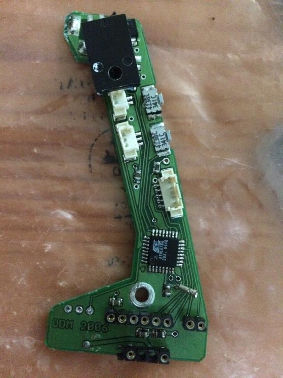

    I bought a box of mag stuff that had this board in it. Does anyone recognize what it is?

    Looks like some sort of prototype... "2006"... looks like it was populated then depopulated..interesting

      Its got an Atmel Atmega88 microprocessor with larger flash memory instead of the smaller Atmel AT90S2313. It has 4 times the amount of flash memeory, 8 time more ram, 4 time more EEPROM, and operates at 2 times the speed.

        Interesting, so that would get over the program size limitations that the original board has.

          Yes, you could load a significantly more complex program into the microprocessor. It would also have the capability of holding more user programmable messages and settings.
