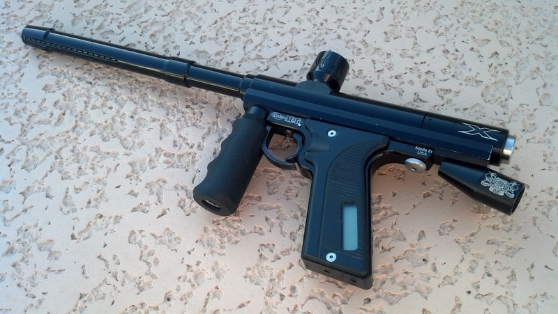

                            Elcd frame with ULT. Got a good kingman 9.6v in there too, so I know the sear is getting tripped fully. It seems to happen at random.
                            Originally posted by athomas
                            The drop test is about dropping the same ball multiple times. It should be able to be dropped 3 or 4 times before it breaks. If it breaks on 3 or less drops, then it is considered to be very fragile.
                            A 0.689 barrel on 0.687 paint isn't considered overbored, since paint will vary by quite a bit even in good batches. If you are getting barrel breaks, you should try a 0.691 or larger barrel. Our paint in my area is 0.697" and I personnally use a 0.696" barrel for everything.
                            Man that's some big paint. I'll test again when I get home, but I'm pretty sure the paint shell is med-tough. I bounced quite a few that day. I really think the lvl 10 might be the problem. I remember testing it with my finger before I played and it kinda hurt. way more pressure than I was used to in my previous mags. I should note, this is the first time playing with this setup... my first time in several years actually. For reference, this is my gun...
