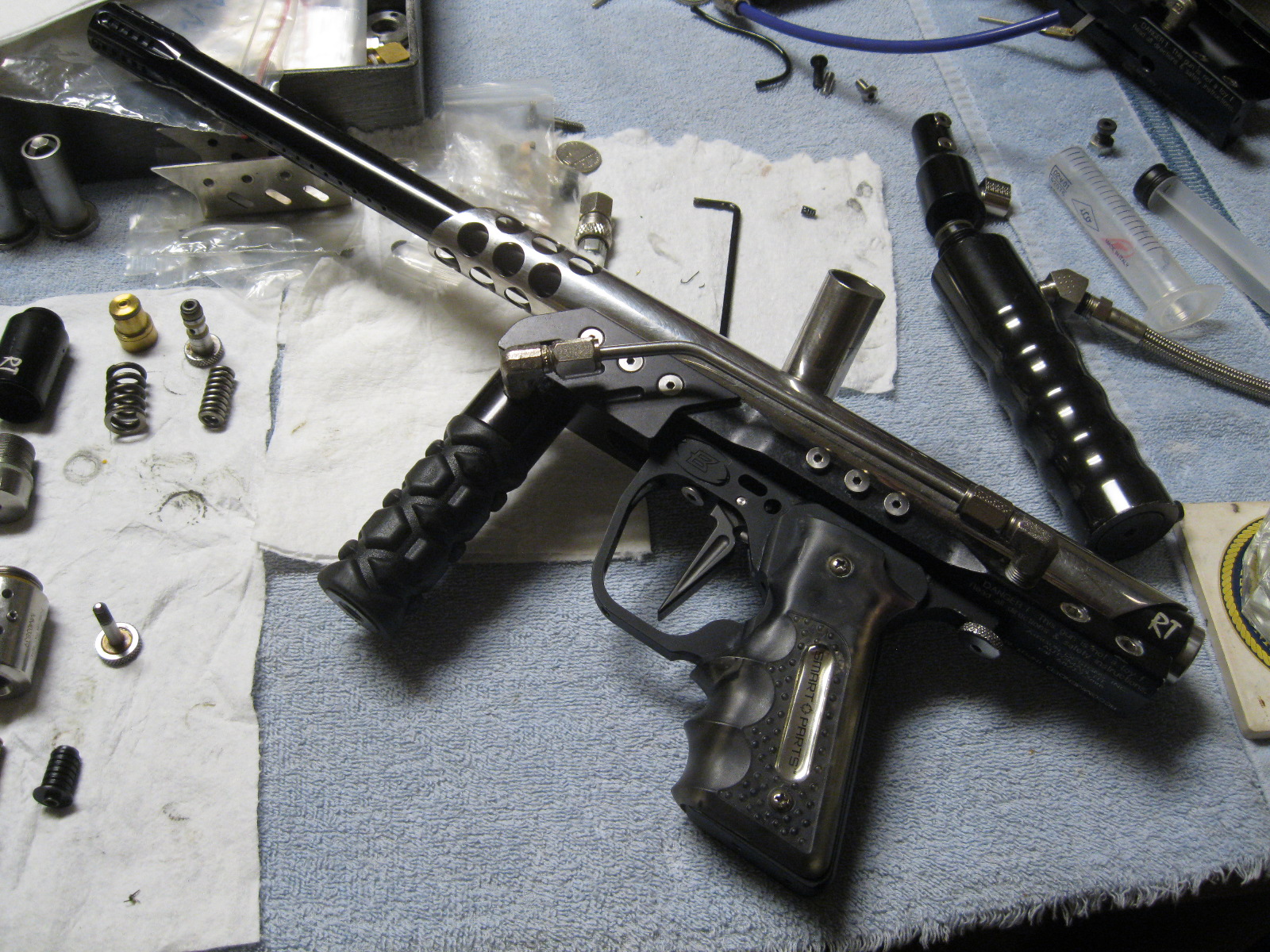

            ok, you mean can you take the bike grip rubber and swap it with the rt classic / rt pro rubber. bit of miscommunication there! yes, you can do that...the OD of the aluminum handle on both grips is .875" (just in case you want to use some other mountain bike grip of your choosing). i did this, just now, to demonstrate:
            the rt classic / pro rubber has a rubber groove that fits into a channel milled into the aluminum grip, which makes removal a little more difficult than on the bike grip (which can just slide down if pushed from the top). what i did, was just screw a macroline fitting into the bottom of the rt classic grip, get it on the floor, and push the grip down while twisting. the rt pro rubber would be slightly harder, as that grip is not a gas-through grip like the rt classic is.
            anyway, i hope that answers your question now!

              Sweet! Thanks for your help on that! So literally I can use other bike grips in that dimension? My foregrip has awesome ano so I was figuring out ways to still show it off.
