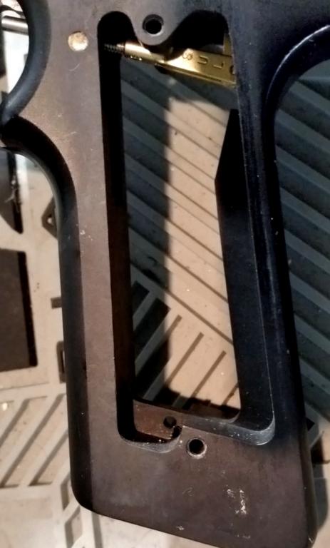

    So I have a PTP frame here with a standard sear which seems to be "Autoresponse-ready":
    -> Can anyone confirm if "all I need" now in order to make this into an AR type frame is the AR sear + linkage + spring?

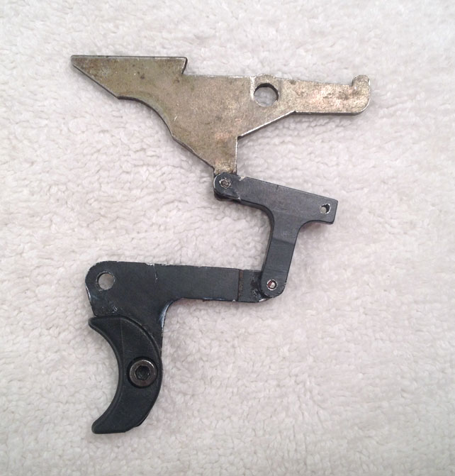

    (picture courtesy of bacci PB) :
Name:	linkage + sear.jpg
    If so, will the linkage + spring work with any type of AM/MM sear or do these use another type of sear (hole located on different position on sear arm)?

    just figured out the sear-question myself by looking at the picture of the linkage and sear: the newer type of AM/MM sears should work (at least in terms of the shape) not too sure about the hole location though..

        • Grelvire
          • 302
          If you look at the sear on the autoresponse there is a circular cut in the under side towards the front to clear the sear during actuation, you may have to grind the sear abit if you cant find an auto response sear, if i recall its the diameter of a nickel
            looks like you could just use a newer style sear. they don't come down like that in the front, so it may have the clearance needed.
            • flampaint
              • Nov 2013
              • 448
              yup, that's what I figured, the newer style AM/MM style sears will fit this application. The old type of sears (with the added material on the lower side) would have to have some material cut or dremelled out - good thing I have some new ones lying around here.
                That is correct - it took me a while, but I ended up figuring it out myself too after looking at the design of the linkage and how it works for a while...

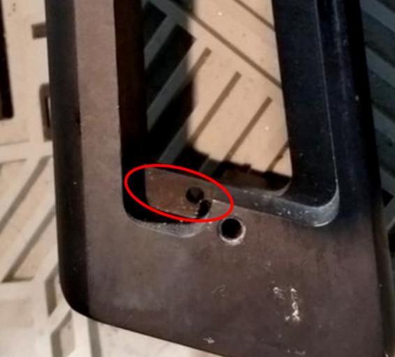

                        So what makes this frame " AR " ready ?
                        • flampaint
                          • Nov 2013
                          • 448
                          This milling + hole - which allows for the spring of the AR linkage to be attached. Some PTP frames don't have this milling (well, at least two which have gone through my hands in the past months didn't have the milling + hole... )
Name:	AR frame.jpg
