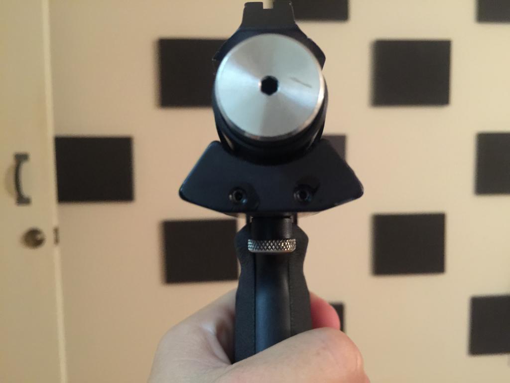

    classic automg rt rail
    hello all fellow ballers! I was hopin someone could tell me what these set screws on the back of my rail are for?

    They seal off the air channels. When they drill and tap the six NPT ports on the sides, they connect them all together with those two holes in the back.

      yes, leave those alone.

        whoops too late, guess I need some good high pressure sealant now. . .
          blue loctite should be fine.

            I was hoping to run a shp ninja regulator, or maybe a maxflo regulator, blue loctite will hold the pressure in the gun?
              it should. i used a ninja shp on a gun that had ccm marcoline fittings sealed with blue loctite.

                Blue locktite will work well.
