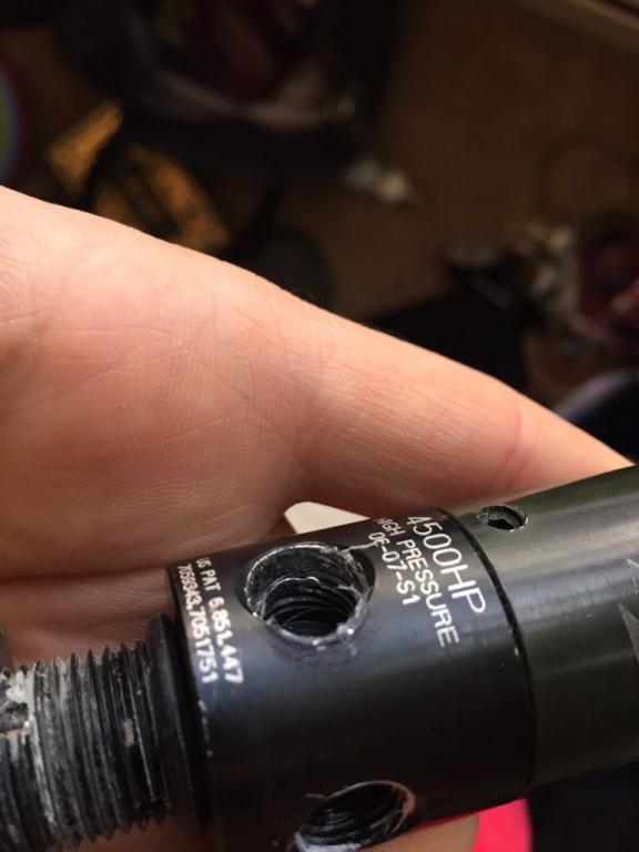

                  Stripped some threads on fill nipple of my reg
                  Took this earlier.

                    Did you and Going Home go to the same mechanics school?
