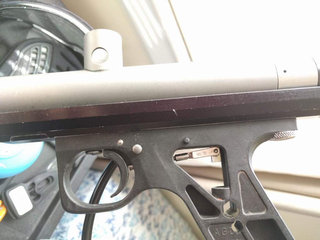

                    Update: so i just got around to adjusting the trigger rod again. Yup doesn't touch the trigger when gassed up. And to be specific, it's a gap about as thick as a credit card now.
                    Though i will also note that i've been gassing it up and frequently testing it throughout this whole adjusting issue and can't say it has ever fired since i put the ULT in.
                    • Laku
                      • Nov 2012
                      • 940
                      That sear looks really odd where the rod clavicle attaches. The clavicle should be at the bottom of the sear "leg?". See picture below.
                      edit. But I guess that's normal for those old style sears?
