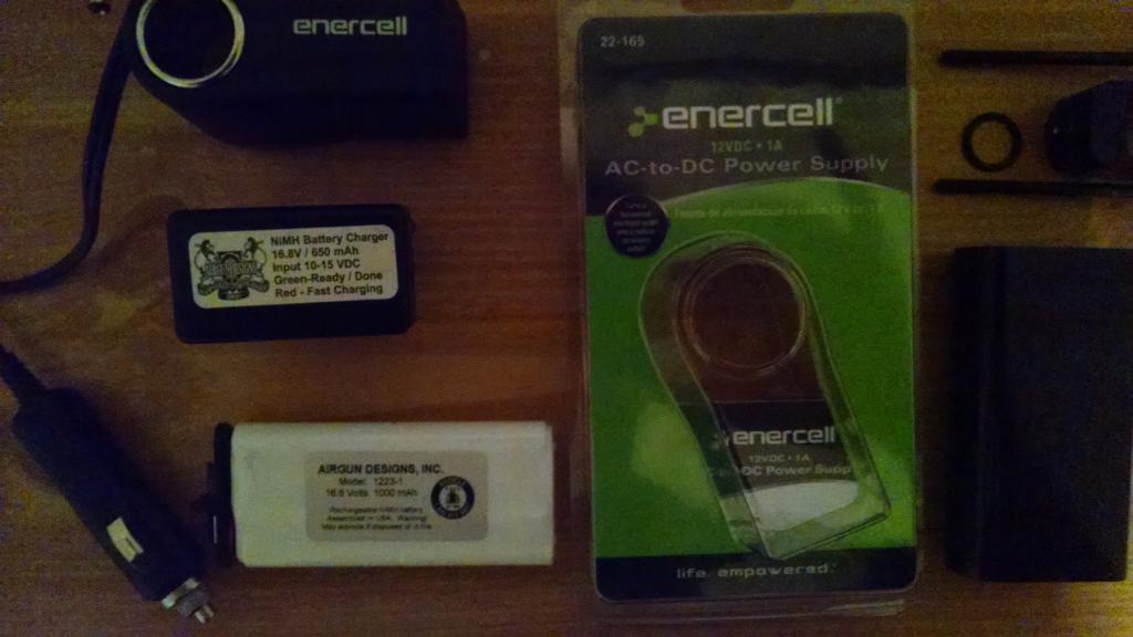

      Yes, here is my current set-up for reference.

        You can get a volt meter real cheap at Harbor Freight or Radio Shack. You need 26+ volts coming out of that charger. You have to check that and the battery voltage first.
