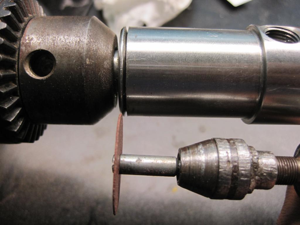

    mount the engine on a drill "slow revs" cut until the orange gasket shows up
    if its done with patience you wont mess up the gasket

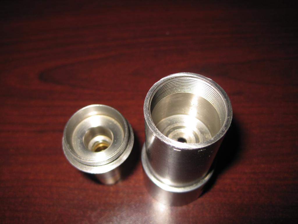

    opened view

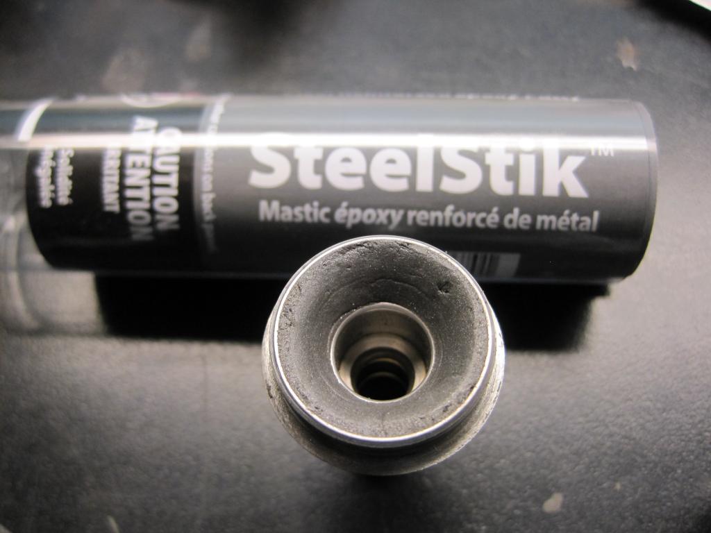

    Im using quick steel to make a cup face for better flow

    gonna try to use a hose for the other end
    any ideas would be nice

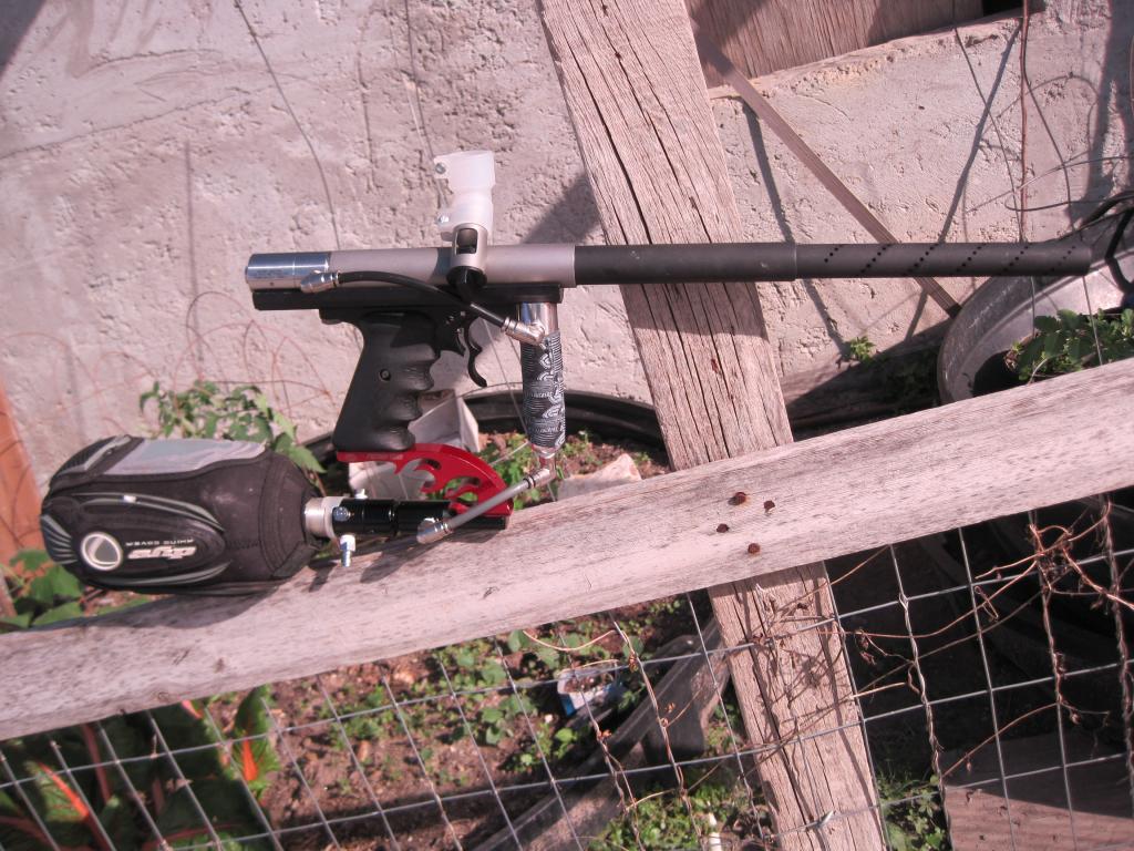

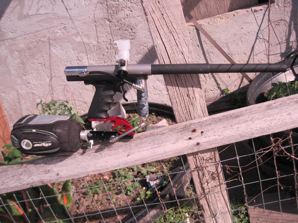

                          my baby ready for some test
                          I dont know if its gonna help but its shooting in 312 FPS +-3
                          ran out of air but it was shooting awesome
                          heres my baby with all its mods
                            [ATTACH=CONFIG]92398[/ATTACH]
                            dont run it at 312...run it at 285-290.
                            • blackdeath1k
                              • 2436
                              My markers are normally set 255-275. It's always appeared to be easier on paint. And what little distance lost is ALMOST never noticed.
