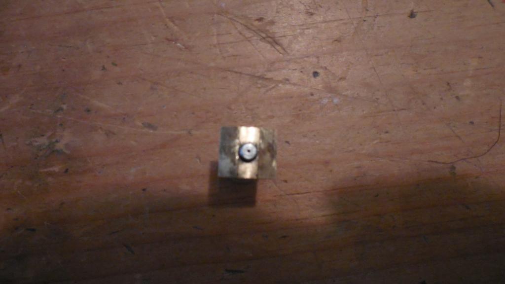

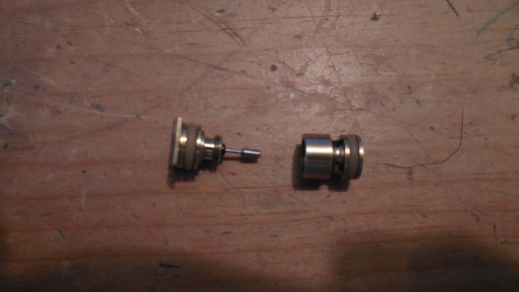

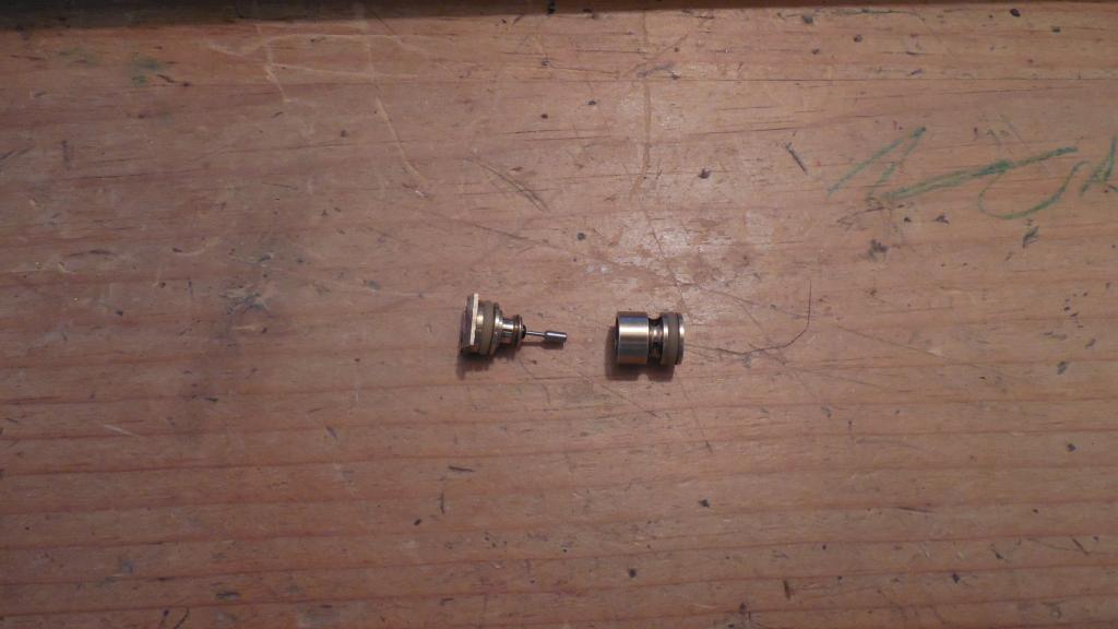

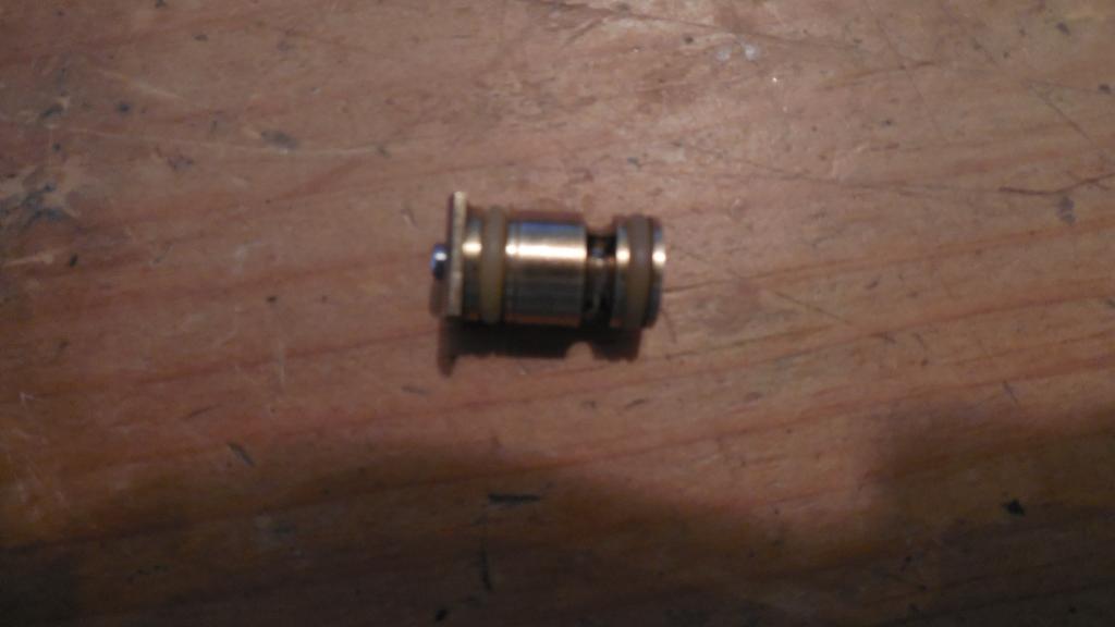

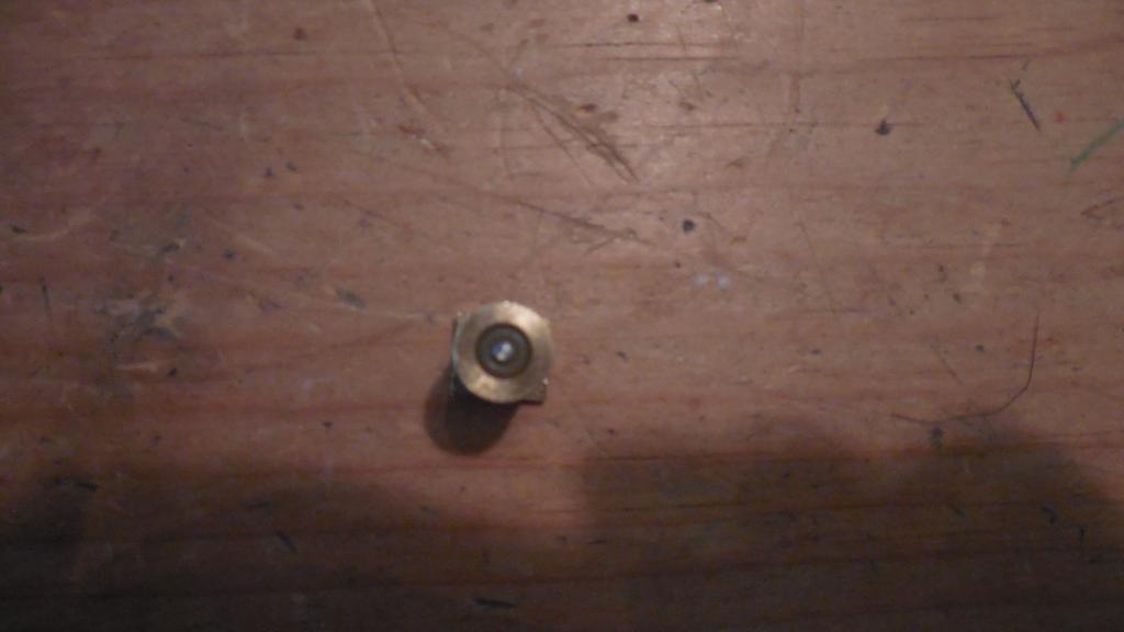

    Hi everyone,
    I was able to get my hands on an X valve in a huge lot of paintball gear I picked up a few weeks ago. I was able to make it have the RT effect in my Automag RT Pro but not with my classic Automag. I have the Ninja SHP regulator so I know I'm getting a high enough psi. I pulled out the on/off assembly out of the X valve and noticed it didn't look like the right assembly plus it started to leak. I put the on/off assembly from my Automag RT Pro in to the X valve and it worked like clock work. I ordered a new on/off assembly for the X valve from Airgun Designs so I will be rocking and rolling soon.
    My question to you all is does anyone know anything about this kind of on/off assembly? I provided some pictures so you can see what I am dealing with. Thanks!
    Thats a ULT (ultra light trigger) on/off.
