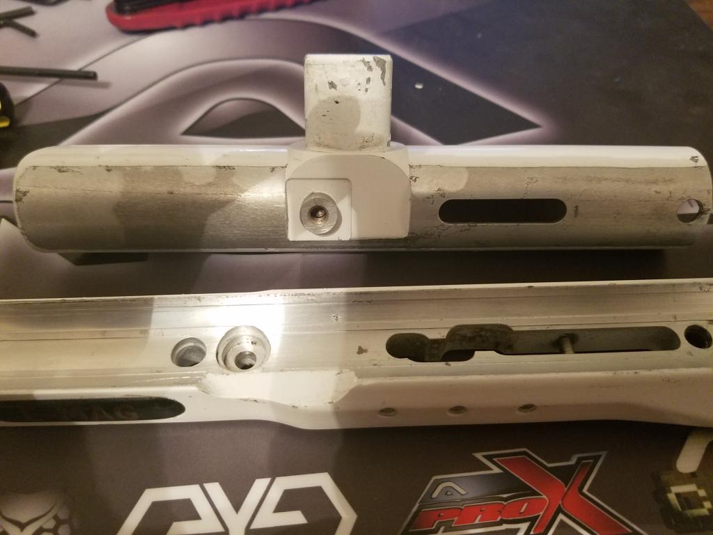

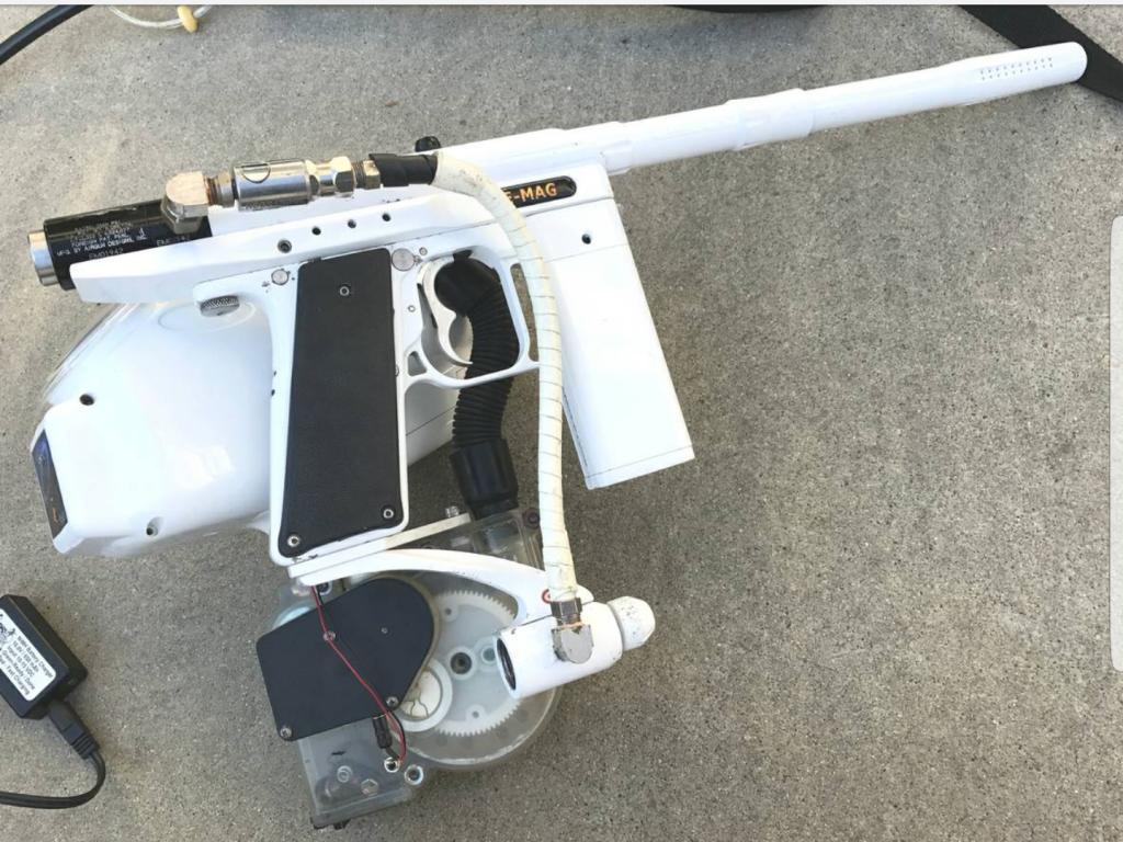

    So after being away from paintball and mags for sometime I decided to pick up a project mag and it definitely has not disappointed as a difficult project. I'm not sure what the previous owner did but it's in need of alot of tlc and going to have to figure out what to do with this white paint/coating!

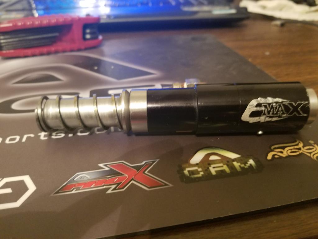

    What's so special about a Emax? I'd never heard of them, what parts kit is needed for it, the rt or X valve? Also what bolt is in it? Lvl10?

    An Emax is just an X-valve with Emax engraved in it instead of an X. Its a bit special, just for that reason. It does have an level 10 bolt. You will need an X-valve parts kit for orings.

      This marker was a topic somewhere else also , if it's paint it's easy , D & A and paint remover IF it's Powder coating ( that was done correctly ) that's a completely different story , that stuff is tuff , one might consider Painting over it , I wonder what a lazer would do to it ??

        Thanks for the input. I asked about it over on the automags Facebook page before I bought it as well. It got very different responses! It doesn't appear to be powder coat but if its paint its an attempt at a professional job, but is already chipping in multiple places. They were smart enough to mask off most of the fitment areas before hand, the only issues with the coating I've found so far are the safety and trigger but it could just be dirty causing it as well, haven't gotten it completely torn down just yetClick image for larger version

          The problem with painting aluminum is that aluminum oxidizes causing the paint to lose adhesion. You need to apply zincate to the aluminum to etch it and coat with a zinc layer. Then the paint will stick to the zinc.
          Yoiu shouldn't have any problems getting the paint off and taking it back to the raw aluminum.
