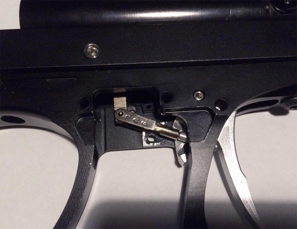

          Here are the set screws I put in to help guide the rod.

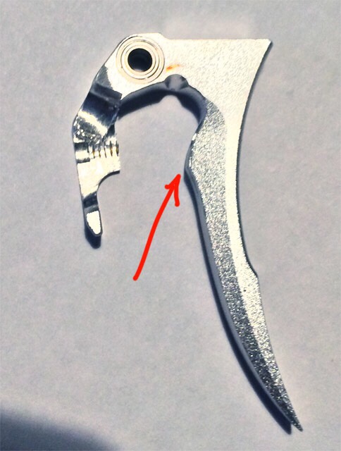

          You want the rod tip to ride that hump in the trigger, if it drops below it can bind.

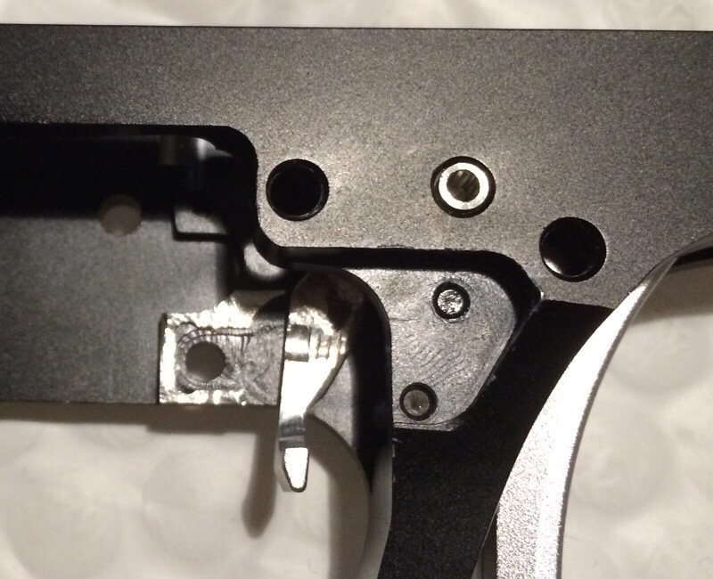

          And in here you can see the modifications Renie had already done for the frame. Also you can see how the rod tip can bind with the trigger.
