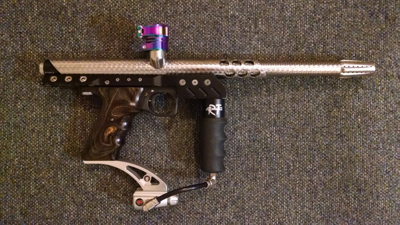

        Guess yall didn't pay attention to motm. This is my classic rt i put together. I have another im working on that that i haven't finished yet that will push the envelope a bit more. still in the works though.

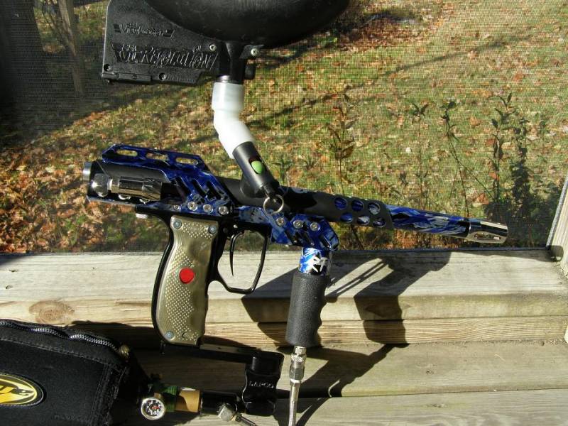

                Thats my blue/black Rt old picture but guns still the same just in pieces, that one is a pnuemag M90, lvl 10, the valve is reactive as hell but it was tuned to be that way by the master.
                My other Rt is a electro, E90, lvl 10, ult.
                Oldironmudders Rt has a set of Emag lowers mounted.
                So anything is possible if you know what your doing or have friends who do.
                    The pinky mod, a standard ULE on a classic RT.
