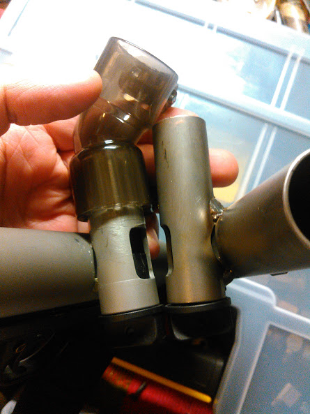

            I've cut down the feedneck on most of my automags. How much you can cut off depends a little on what elbow you're planning to use, though you should always err on the side of extra. You can always trim a little more off, but you can't put it back on. On right feed bodies, I think I've cut about an inch off on most of them. For powerfeeds, though, maybe half an inch.
            Here's one I did (on the left) compared to a standard powerfeed (on the right).
            Probably could have gone a little bit shorter, but you get the idea.
            I've tried just about every method to get them off....hacksaws, power saws...but the best by far is actually a simple pipe cutter (like the kind you use for copper pipe). It's a much slower method, but the final result looks so much better and straight. And there's never any serious burrs to grind off afterward. A little sandpaper usually is good enough to remove any sharp bits.
