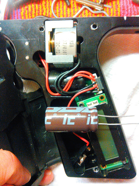

                        Well, the capacitor arrived, but it's not gonna work. It's about 1/4 inch too long. *sigh*
                        And here I assumed that all capacitors with the same values would be the same size. Time to go shopping again, and I'll pay more attention to dimensions this time.
                          • 8248
                          I have one that should work, what is the rating on the original? The ones I have are 1.075" long
                          • rawbutter
                            • Feb 2007
                            • 1463
                            That should work. I need a rating of 6800uF and 10v.
