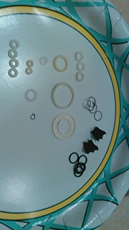

      When I lay the old ones out, I can not find ones that match in the pile of new ones. Are the new ones smaller and stretch to fit?

          The 3 orings in the upper right corner look like the ones you are looking for. The 2 small ones together on the left look like on-off top orings that would fit inside them.
            I dont think so...
            Top right 3 look like L10 inside the carrier orings
            Top left 3 look like Reg pin/on/off top orings
            The single oring above the black circlip looks like the powertube/on/off hole oring.

              #21
              After work I will lay out the old o rings along side the respective pieces of the on off assembly, and I'll lay them next to the new ones.
              When I did this earlier though, there were no obvious matches for the top and bottom o rings in the on/off.
              I believe I have the two small o rings.
              I'll try again tonight, pics to follow.
              Thanks,
              Jim

                #22
                Originally posted by Tunaman View Post
                I dont think so...
                You would know better. I was having a hard time with size comparison and was just going by ruler and percentage approximation on a screen. It was difficult due to the resolution. Obviously not accurate enough. I should have gotten my orings out and did a real size comparison.
                  • 8643
                  #23
                  Well you know also... after seeing these orings day in and day out for 20 something years just looking at them becomes second nature...until you run into the #780 banjo bolt orings. They fit NOTHING else in a mag. When i think about the above picture more, the oring above the black c-clip may very well be the plastic backup washer. That washer and the powertube oring are basically the same outer diameter. Hard to tell from the pic.
