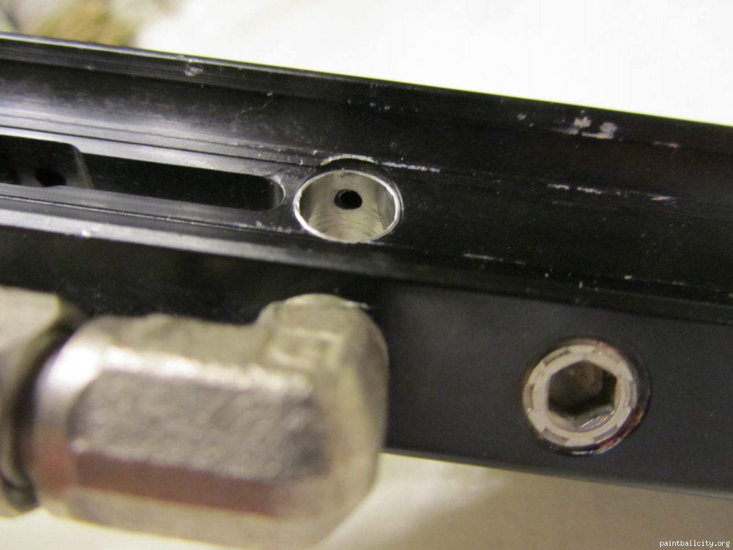

          Originally posted by Mondoatx
          Did the best I could... couldn't quite match the angles or lighting...
          Let me know if you would like me to post them on the referenced thread...
          Also... I don't see a huge difference betw what is posted on that other thread and what I have here... if someone can/does notice the difference spell it out for me.
          Thanks all!
          Just having pics of a known leaker rail is helpful, even if the difference is hard to see. Thanks!
          The chamfer, or inside shoulder looks smaller or a steeper angle on this one. It could be the lighting. [Like the old rail has a 60 degree chamfer and the new one has a 30 degree chamfer]. I'm thinking that the rub mark on the rear side of the rail is just from backing the banjo bolt out while the o-ring is jammed up in the front.
          If the rail was actually thicker, that should have shown up on pin lengths, like newer RTs being more reactive than early ones. Anyone notice such a thing?
          For the pic record, this one below was my first attempt at improving the shoulder in the banjo hole. The final one looks about the same without the dents (and didn't leak from the sleeve). This is why I'm pretty confident of the problem, but we could use an easier fix for customized RT rails.

            Spider,
            So that sleeve reduces the diameter of the hole the banjo goes through... and this keeps the middle o ring from coming out of its' groove and getting caught between the rail and the bolt (like what happened in my picture the other night)? Am I understanding that correctly?
                I think it is the same inside diameter. It mainly raises the id up higher to support the o-ring. I haven't lost the middle o-ring since. It has had some solid play , as well as a bout of level 10 tuning.
