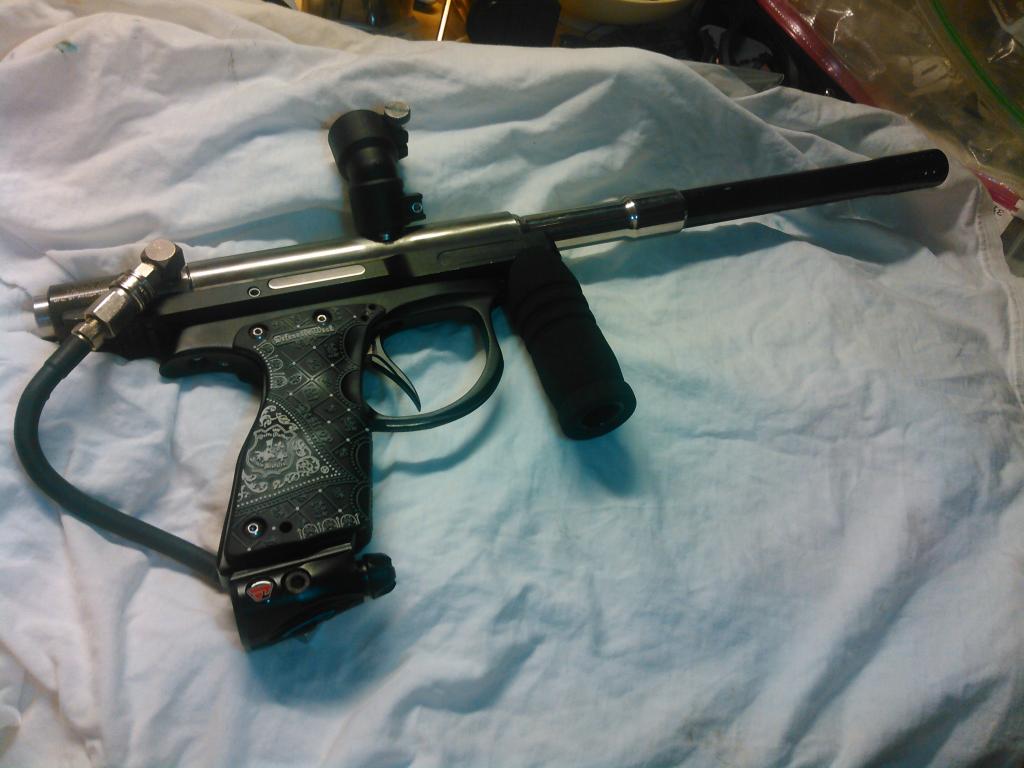

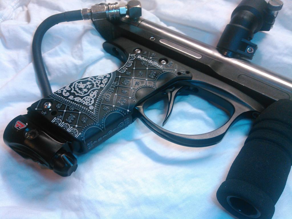

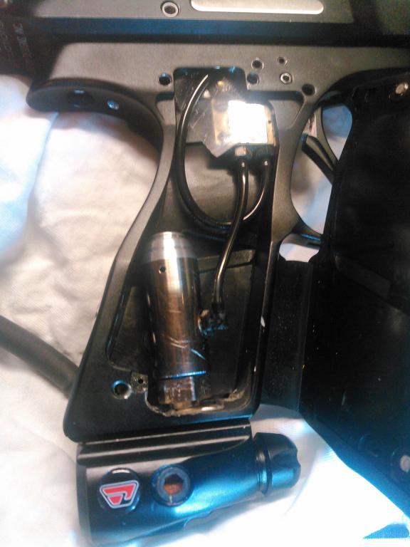

            I think the main difference between a pneumag and electronic marker (besides not needing batteries) is the lack of modes. If you can shoot a pneumag at 10 bps, then that's YOU doing the work. You've learned the skills to shoot fast. But if you just buy an Ion and set it ramping at 15 bps, then that's a different kind of advantage. So I think it's great that your field separates the two, and I think that using an RT mag in a mechanical-only game would not be fair. So yeah, pneumag or ULT is what I would personally use in your situation.
            And to answer your opening question, people are indeed still making pneumags. I think that folks just don't post up about it as often because they're not as novel and new anymore, so why bother showing off what someone else has already done better (probably)?
            You can buy kits from knownothingmags for about $50. Another $20 will get you a decent LPR. And if you don't have the right tools, I'm sure you can find someone here to do it for you. Just post up and ask. (I've made four myself this year alone. See attached for pics of the latest one that I made with a Dye UL frame and sleeper set-up.)
            As for pros and cons, I think the pros are obvious. Short, light trigger pulls. No batteries. Less finger fatigue. There really aren't that many cons. The parts don't seem to break down that often. (I've owned my oldest pneumag for 8+ years now, and I haven't had to replace or fix any of the components.) Some people think that the LPR sticking out somewhere is kinda ugly, but I don't think so. Autocockers have way more things sticking out everywhere, and people don't think of them as ugly. Honestly, the only serious drawback I can think of is that pneumags use even more air than regular mags, but if you're playing at a field and refilling your tank between games, I doubt that's a problem for you. So I say go for it.
